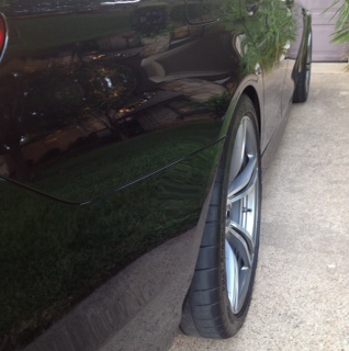

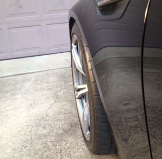

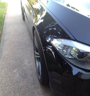

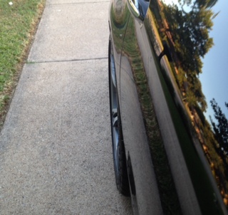

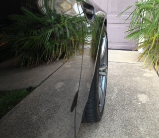

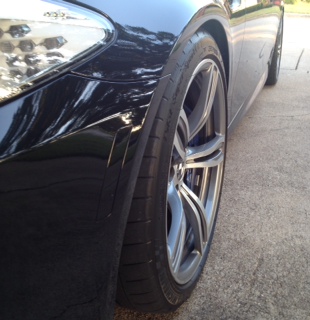

I have 10 mm Macht Schnell all around, with 343s, no rubbing or weird handling issues.

      07-13-2014, 08:31 PM   #22
M5TXGuy
M5TXGuy's Avatar
14
142
Drives: 2013 M5 BlackSapphireMetallic
Join Date: May 2014
Location: DFW
Originally Posted by MPowerrF10 View Post
This is obviously on a non CP car? Do you have oics you can share?
Perhaps these will give you the perspective you are looking for. Again, this is 10mm Macht Schnell all around. This is a 2013 M5 non CP.
