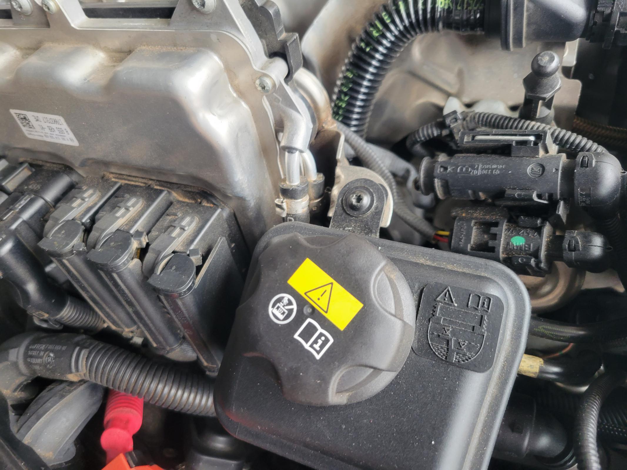

I took a look at mine and realized it takes a little more work than i remembered.
-Remove engine cover
-disconnect battery
Bank1
1. Remove coolant reservoir screw and pull aside
2. Pop DME off, no need to unplug anything
3. Remove both bolts behind DME bracket and pull aside
4. Remove two bolt holding PCV on
5. Unclup PCV from intake
6. Re assemble in reverse order
Bank2
Everything except skip step 1 above.
