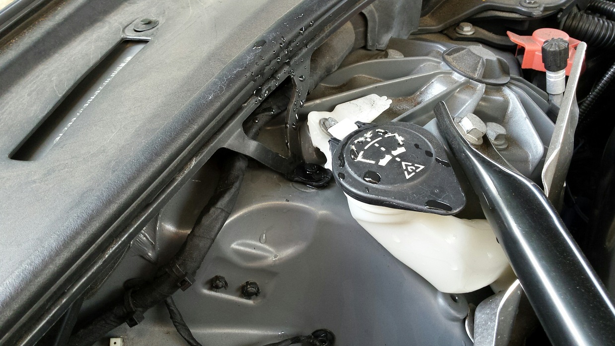

My '14 M5 also did this when I first got it last year.
The solution was to replace the reservoir cap. It snaps on/off and has a part number 61667238068. This is #11 in the diagram attached.
The seal is pretty flimsy and I think the engine heat kills it after a while allowing a lot of evaporation. The part is very inexpensive and no tools are needed to swap it.

Thanks guys!
Installed a new washer cap yesterday and filled it back up. Hopefully this fixes it.

Quick update on this....
This fixed the issue. I haven't filled it up since I replaced the cap.
Thank you again!!
