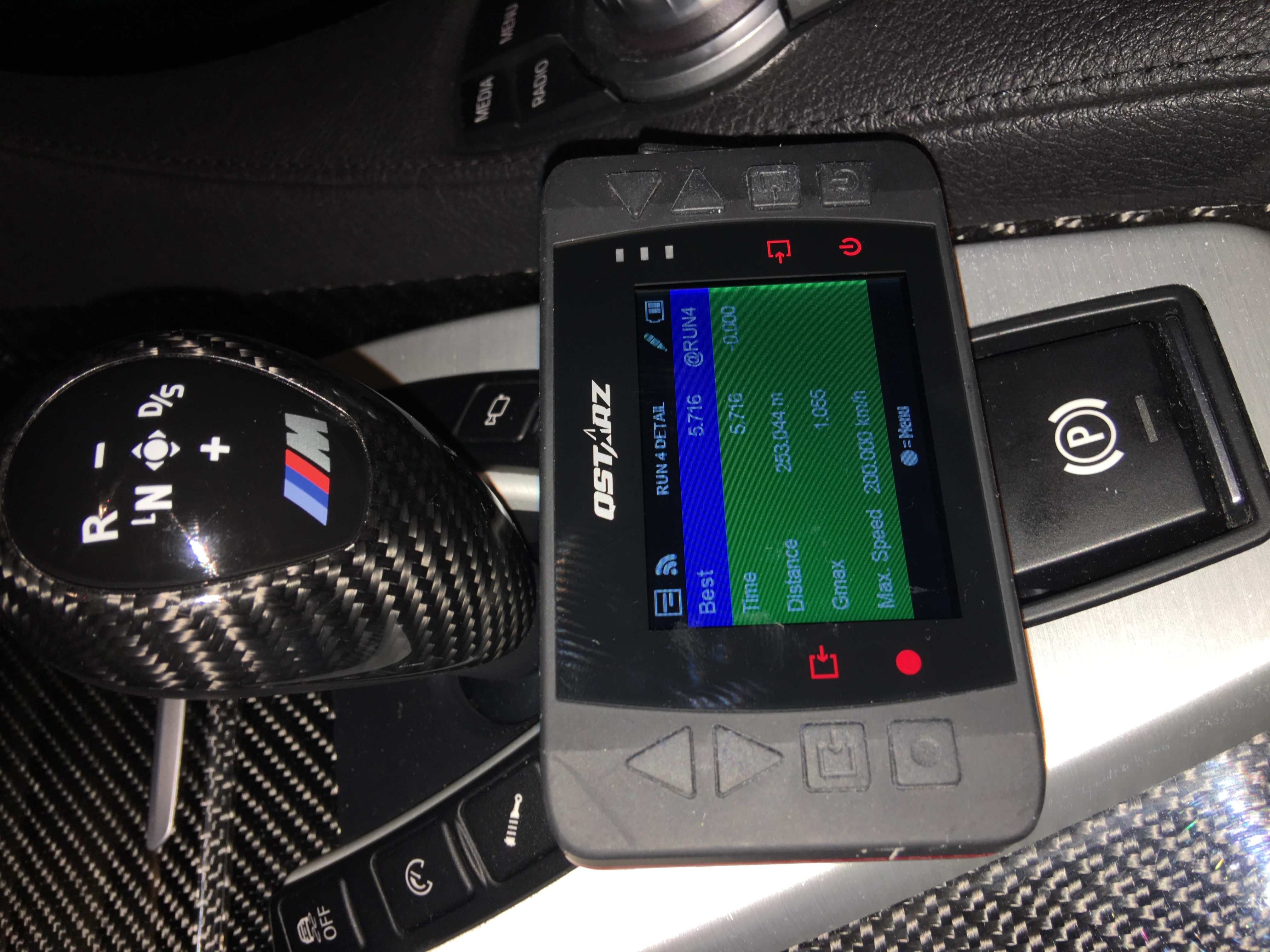

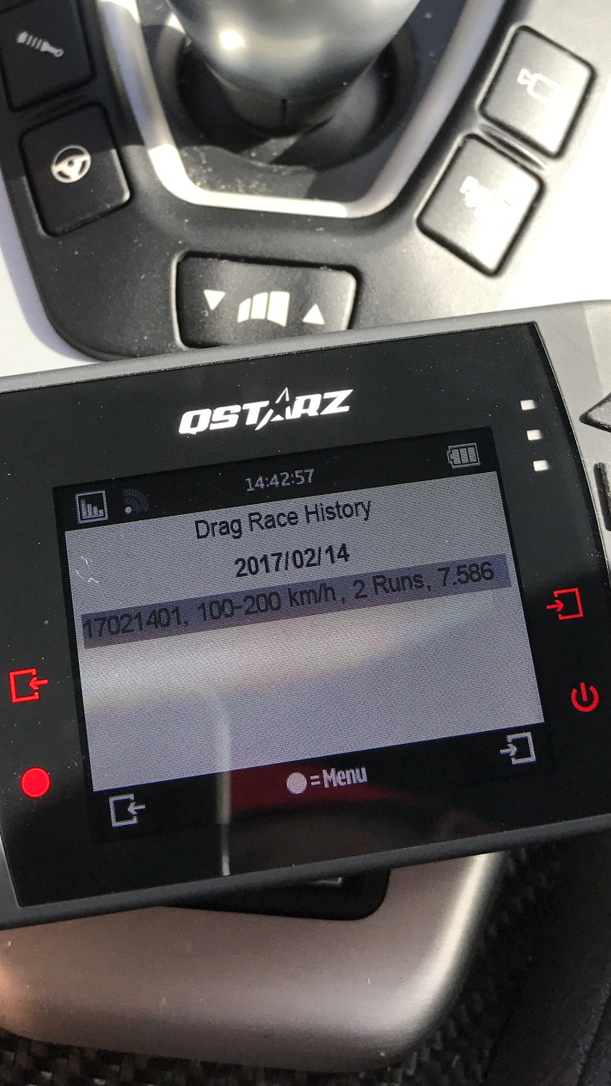

I have done some stock times with original cats.
About 7,6 sec.
I can flash today my car to stock tune and do some 100-200 runs with the installed Original decats.

5,72 sec. with qstarz on dry road.
Now i ordered the dragy to correct the time. but right now we have a rainy weather. 6.0 sec. was on wet street with dragy.
Maybe these day will be dry and i can try some new measurements and correct the times.
