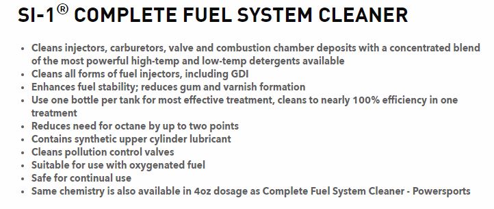

I'm just getting back into a BMW having owned two previous, (E39 M5 and E90 335d,) but having owned a couple Z06 Corvettes in between, I came across and really thought the Red Line SI-1 Complete Fuel System cleaner did a good job helping to keep the fuel injectors nice and clean. I buy it by the case off Amazon and split it with my Dad.
A full bottle treats 20g but I usually only do about 1/3 to 1/2 a bottle every third fill up as preventative maintenance and peace of mind. I just took delivery of my new-to-me 2015 M5 this last weekend so I dumped in an entire bottle when I filled up the tank with Costco 93 as the vehicle had been sitting outside at a dealer in MN since February. I know BMW says you don't need to add anything, and I would not add 95% of the stuff on the shelf out there, but I've read some really good reviews on this in the Corvette community and I know it's doing nothing but good in my motor.
https://www.redlineoil.com/si-1-comp...system-cleaner
