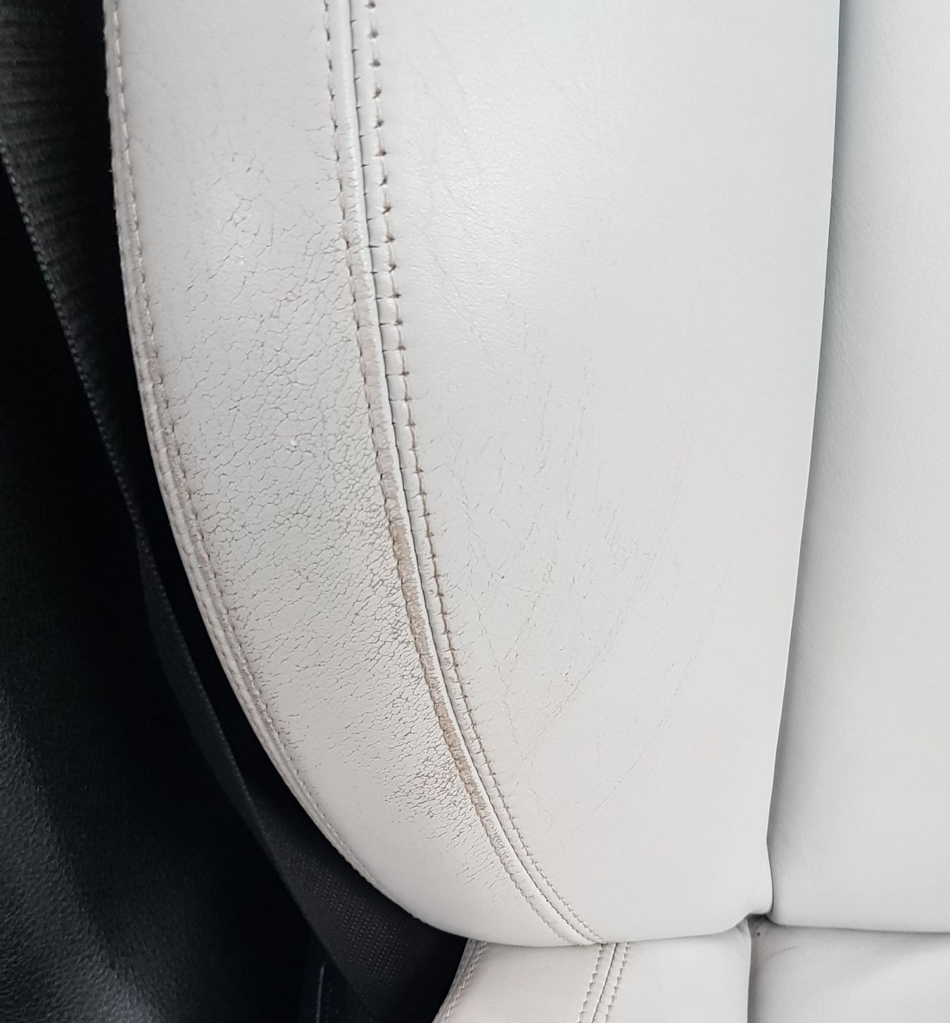

I have various Marks on my interior, some are worse than others to the point where the leather is actually cracked.
I've attached images, does anybody use a product that I could use to repair this or make it look better? I understand that i may not be able to repair the cracking but it would be nice if I could tidy up the small scuffs.
Thanks

First and foremost you need a leather cleaner to remove the coloured scuffs.I have Auto Glym leather cleaner but have never used it on my black merino as not needed.All I use is a cream leather conditioner which also cleans is used from Lidl and does the job well.
I think you need a leather dye applied sparingly after it is cleaned on the damaged patches and have seen kits for these on US sites applicable only to M5 leather shades,can't remember if it was on the general forum or the cosmetic section.

I bought an excellent kit for my E61 M5 - it also had the Silvertone leather interior, got it from these guys....
https://www.furnitureclinic.co.uk/Leather_Repair_Kit

Looks like I'll be ordering one of these kits.
What cleaners do you guys use? I currently use Meguiars gold class and a soft brush for my deeper cleans and Megiuars mirror bright lotion for my maintenance cleans. I'd like to get them even cleaner if possible.

I've had great success with Sonax foam. Keep in mind you want to use something that won't clog the perforations in the seats.

You are wasting your time if you use anything other than Leatherique.. Get the $100 kit that includes their rejuvenator and prestine clean. trust me. it is unlike any other product. it is hardcore and used by rolls royce and ferrari collectors. it will mske cardboard hard old leather like new. anything past its abilities are rips or tears but nothing will fix that. for color loss from chaffing just use a matching dye that will stain the backing of the leather which is whst is exposed causing a "discolored look" .. if its just dirt or staining leatherique will fix it and dont worry its safe on anything and any color. it will come with detailed instructions. but just put it on in warm weather and let it set for a day

and this worked absolute wonders. let it dry and clean it off with lexol conditioner. it will come off surrounding leather but will stay on the exposed fabric that needs coloring if the leather is actually damaged.
Ive never had luck ever fixing a break in leather because patch will end up breaking too because it's in a stressed spot on like the bottom of the bolster from when you get in and out of the car ...it can fix a tear that maybe just happened from a curtain rod being put in the backseat or something somewhere that never gets any pressure but if it's a pressure break it's just going to break again youll need a reupholster

that kit you bought that schrickm5 suggested is for fixing large breaks and tears. you don't have that going on, you just have chaffing and you only need a dye. trust me because I have used a kit just like that one before and it says matches any color because it comes with all primary colors and white & black so it gives you the opportunity to match any color yourself, but dude it's like impossible you need to get a dyr from the link I gave you just a couple posts early and order the white or silver. trust me

BeachM5nster is right, I bought a full kit, however you only need the dye and cleaner + conditioner.

Use Bespoke Leather Dye to fix scuffs and wear after cleaning with Leatherique Leather Cleaner
