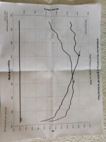

I had 3 pulls on my car today, car has RPI catback exhaust, gruppe m intake and BMS stage 1.
does this look right? these are corrected numbers with a correction factor of 1.2212.

Your pic isn't very clear but from the numbers I can see it looks about right.
sorry.
peak torque is 603.9 on first pull, then 536.6, and last pull 569
peak power corrected first pull 548.8hp then 513.2 and last pull was 527.2.

That's about right. When I ran that setup I was making somewhere in the range of 600-650 crank horsepower. The BMS Stage 1 is giving you the most gains, while the RPI might net you a few hp, but the Gruppe M Intake might be causing hp loss or no gains, those things are really just for looks. The stock intake with the charcoal filters removed give you the same as Gruppe M.

I thought those numbers were closer to a stock setup, OP, but then I see you are in Denver, CO. Did you dyno before those mods?

What kind of dyno is that on? Numbers look real low in my opinion. I have seen 550rwp stock on a dyno jet. Are you sure those are corrected numbers? If those are actual at that elevation that would be damn good. But corrected with a 1.22% correction factor means your only making about 425-430hp.
yea, those are corrected numbers...

Idk why u guys love Corrected Numbers
Better to do Uncorrected as u will know Exact numbers it put down at that time,weather,elevation all that crap.
Ask for Uncorrected numbers then you will know what it put down that day exactly.
