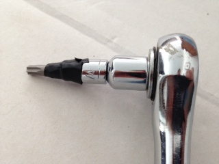

Would this tool be suitable for screw #7
http://www.amazon.com/Sunex-9726-Min...sim_sbs_auto_6
build this yourself with a 1/4 socket at the torx head. if you have 1/4 ratchet it would be easier.
I used a 1/2 ratchet and built this, worked ok but 1/4 ratchet would be better (smaller)
P.S the black tape is there to hold the torx head in the socket!!
That is exactly what I did, with a 1/4" ratchet! Worked flawlessly.
