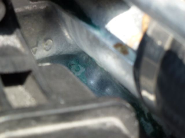

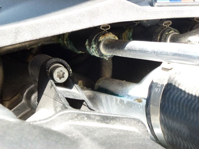

This is what I found this past weekend when I popped open the hood. I have already spoken to my Service Advisor (actually, Service Mgr) and he confirmed it's coolant leak. You guys may want to check yours.

Had same problem and had no idea until I took engine cover off and saw leak. Never smelled it or saw it on ground, or smoking etc.
Dealer fixed under warranty.
Parts Used:
1 x Feed Pipe 11 53 7 844 268
1 x Return Pipe 11 53 7 844 269
4 x Hose Clamp 32 41 1 131 346

Mine was originally repaired with the same factory clamp. They then test pressured it and it failed to hold and leaked again. They had to use clamp with tightening type of screws (double) to fix it, now it has been about 5 months and all are good. No more leak.

I have the same problem. My mechanic said get screw tightening hose clamps. Does anyone know what size, where to buy? Amazon?
      01-02-2020, 05:18 AM   #8
90434
27,098
Easiest job on the planet, measure one of old flex pipes and order I metre high temp synthetic pipe from e-b together with screw clamps.

Yup, yup. Did some research and ended up doing the same thing. Even found it on Amazon prime, will be here tomorrow.
