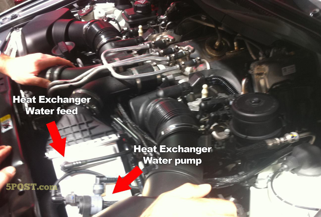

The ///M cover covers two turbos that you can't see because of the heat shielding and some strange looking piping.
Question: What is this strange piping running 2 the turbos?
Question: What are the two strange looking boxes in front of the engine
Answer: These are the Air/Water Heat exchangers, cooling the compressed air coming from FROM the turbos on it's way to the cylinders.
Question: How does the airflow travel from the inlet to the cylinders

I would think the turbos would be water cooled.
The oil might eat threw that rubber connection tubing on the top of the motor?

I thought BMW came out and said that turbos were water cooled, not oil cooled, in a video recently?
Could be, I read the same thing. Though oil cooled makes more sense to me.
Turbos run extremely hot, Oil would be able to withstand higher temps then water.
You don't want to get water vapor in the engine cooling system and turbos run at 300+ deg. Celsius, so for them 2 b water cooled the ///M5 should have a separate pressurized water cooling system on the turbos to eliminate any bubbles forming.
Anybody?

you are right junior. ANother thing to keep in mind, water can withstand certain temperature before turns into gases; thus the idea of keeping it oil cooled is better.
However, that being said, I am assuming there will be somewhere a warning in the Owner's Manual reminding the driver to leave the car on for good 5 minutes before shutting it off when arriving to destination; just to cool the oil a bit.
They are water cooled, made by honeywell.
The above image is looking at the engine without the top plastic shroud, one cat and turbo removed exposing the CCM and all the associated plumbing on the other side. There is a huge stainless cocoon of a shroud that covers all the exhaust components. The ECU and other computers are also water cooled on a separate circuit.
There are three radiators and two water/air intercoolers.... there is a lot of cooling!

Originally Posted by JuniorM3 View Post
Traditionally the air is cooled by an intercooler before it reaches the turbo and enters the engine 'hot', this brilliant design by BMW get cool compressed air to the engine to maximize performance.
Are you sure? I can't think of 1 car where the air goes through the intercooler before hitting the turbo's.

Originally Posted by Blixem View Post
Thanks for the info
Ditto I think he meant to say the compressed air leaving the turbos goes into an intercooler before reaching the engine?
