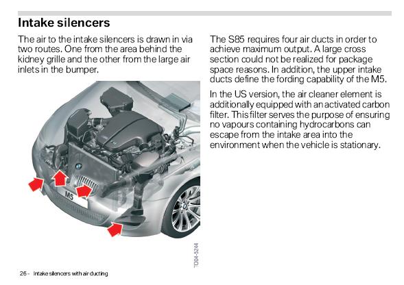

I re-read this thread today after a couple months and still not sure I understand the reason/benefit of the charcoal filter deletion. Can someone shed some light? If it is helping in some way, I'd also be interested in removing it right away.

Engine breathes better. The filters are pretty restrictive. Don't know if there were any dyno results for the F10, on the other e60 m5 it was about 15whp IIRC.

Some people same EMISSION Part for USA.....I wonder?!?!?!
$360 for one so DO NOT TROW AWAY if taking it out!

Useful.
I guess they are installed only in US to prevent fumes escaping to environment when car is off.

I have a Canadian car and it sounds like this was only needed for US cars, do you guys think there is any advantage for me to do this just to change to either the BMC or the K&N drop in filter? Eventually, I do plan on going Dinan or may be RK for intake but maybe I could free up some flow changing my filter for now?

Does anyone know what the snorkel is for and why the M6 has a blocked off plate instead?
