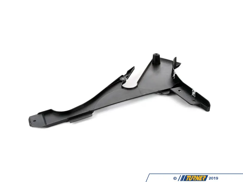

A follow up question that i'm trying to solve:
-I'm trying to figure out what screw is required? Here is a pic of the part from Turnermotorsports. You'll see halfway, there is a piece of plastic that tapers upwards into a corner, and right before it ends is a screw hole. What screw is that? following the schematics here it looks like it could be screw #7 or #12?
https://www.realoem.com/bmw/enUS/sho...diagId=51_7874

Updating that the screw is #7
