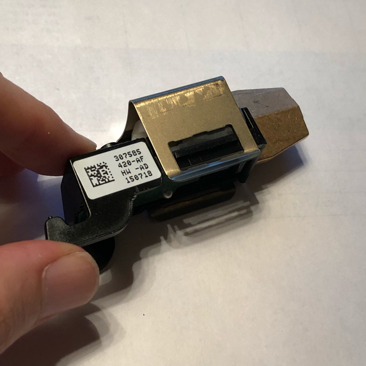

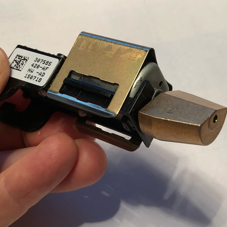

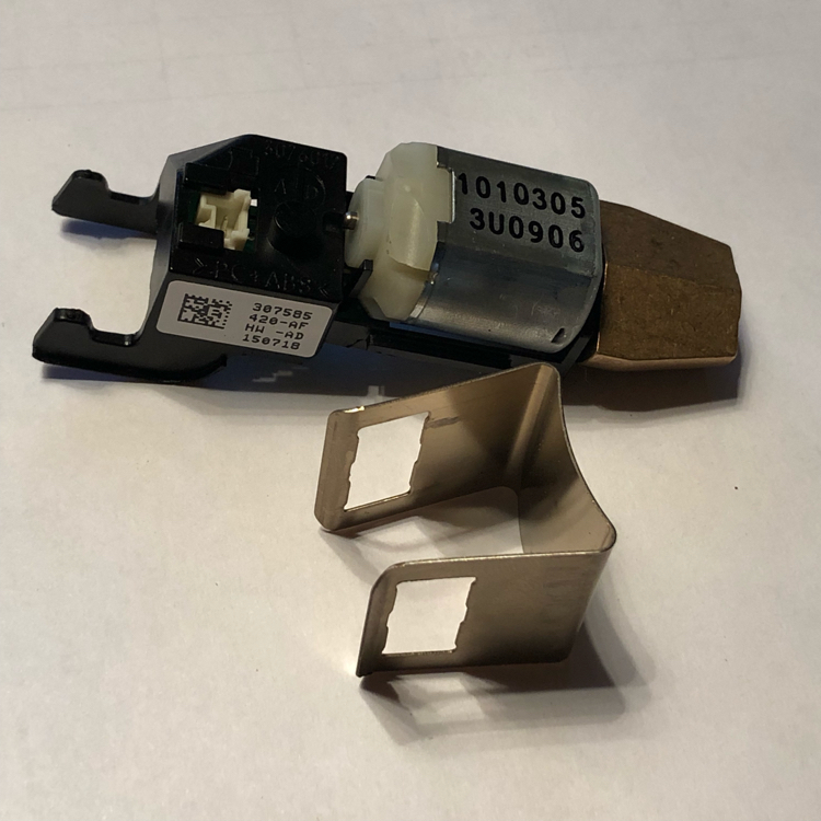

Here's probably why. The steering wheel vibrator is just a cheesy motor with a lopsided weight on it to make it unbalanced and provide some jiggling.
I think it is held on with this enormous metal spring clip which I suspect is either vibrating from the road or passing along the road vibration to something else. I bought this in hopes of replacing it to fix the noise issue but it is such a piece of crap I can't believe this costs about $130. Don't anybody else waste money on this. I haven't taken the wheel apart but I'm guessing the solution is to pad everything to avoid vibration or else remove this thing completely.

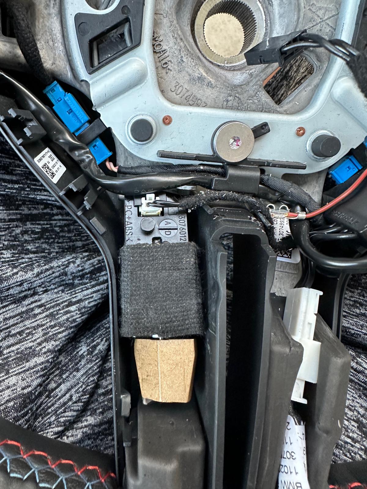

Im having this same issue and its the vibrator
when i took it out the noise stopped.. but like others say it throws a lane departure error since its unplugged.
so i used padding and tape to insulate it from the wheel. it helped about 50% the noise is not as pronounced but its still there and im OCD so this is not gonna fly with me.
next thing im going to try is to remove the metal retaining clip all together and just use electric tape and tape it around the wheel and report back if that works.
If there was a way to code it out that would be best fix. and just take it out.

Fixed my buzzing noise that I was getting at speeds over 60 over bumps and rough roads from the steering wheel. It’s the metal clip holding the vibrator in place. I simply taped to to the wheel n no noise!!

update its not the clip its the acutally bronze weight that has play up and down and causes the horrible noise over rough roads. so i just taped it for now so it dont move and tured off land departure button n thats how im dealing wit it for now

what i ended up doing is just turning off the button that controls the blind spot warning and i just taped up the engine motor in the steering wheel so it does not move and that it
the thing that sucks is that i dont have the light up triangles in the mirrors when cars are in my blind spot but i would rather not have that then deal with the annoying rattle that make this car seem like a civic. i know how to use my mirrors so i sacrifice the comfort feature to get rid of the noise
