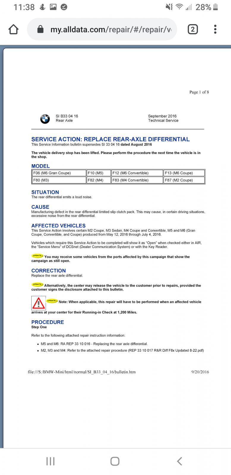

I also have a 6 speed car that developed a nasty whine in first - third after a hard day riding with some of the fellas. I changed trans and diff fluid 3k miles before the trip, checked fluid before the trip, and changed again once the noise started (3/4 of the trip before the noise started). Car is stock and while I pushed it hard it was nowhere near what my 135i gets on a track day. What did you end up coming up with?

I think this is my problem....we will see once I talk to the dealer.
After it started making noise I changed diff fluid also and it was already dark after only 3k miles. Guess mine never got the updated differential.
