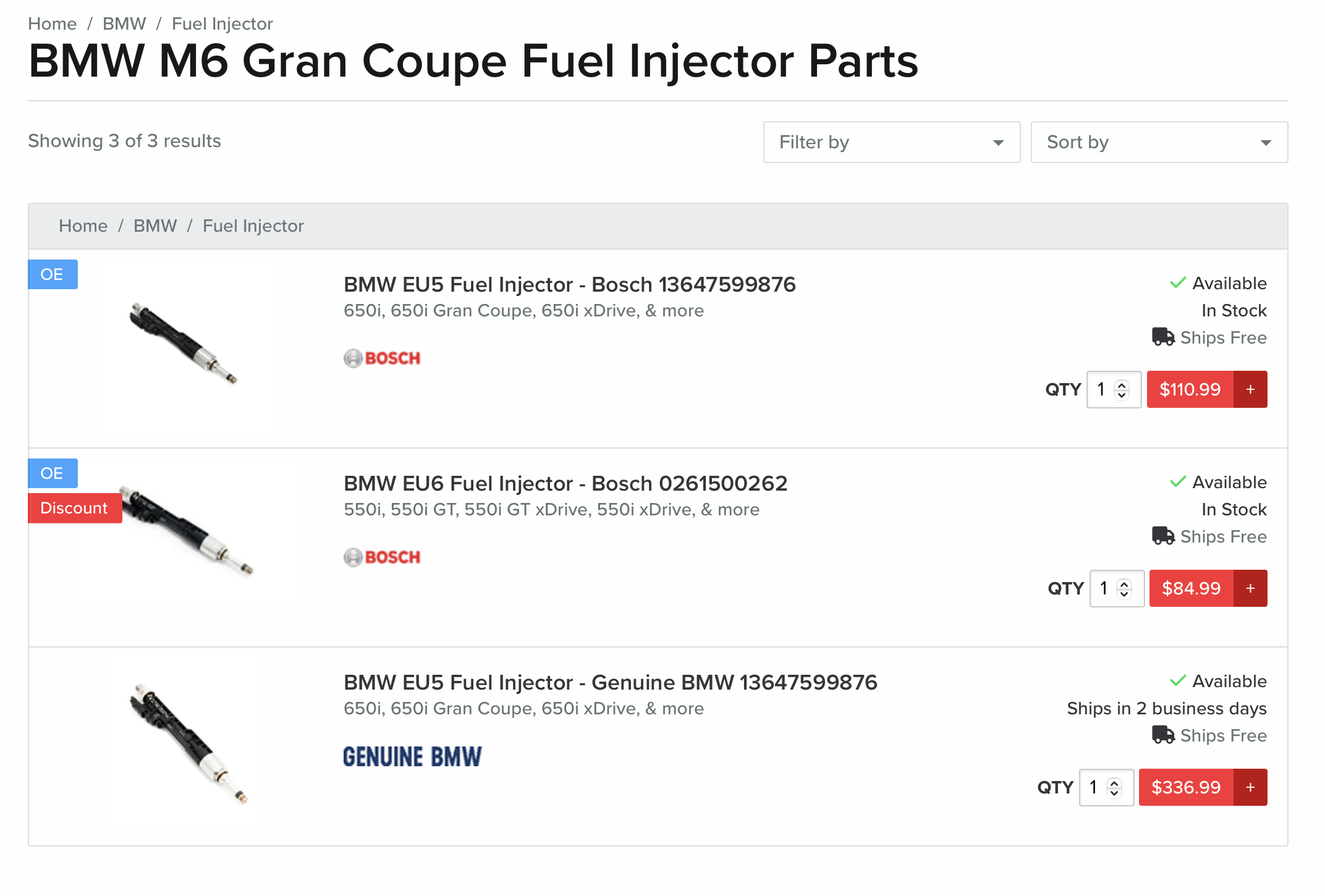

Blackstone reported a lot of fuel in the oil. Did the oil change at 4,000 miles and 8 month spread. Took the car to the dealer as there is warranty on the injectors (10 years / 120,000miles). They didn't find any codes and no oil in the current oil (of course new oil is only 100 miles old, old oil was the one tested...) and because the car is tuned (BM3 stage 1) they said even if they bench test the injectors BMW won't cover them. So I will go ahead and buy a new set and get them installed. Don't want to risk anything. Does anyone have any experience with the 3 options available? One is Bosch vs Genuine (which I thought was the same anyway except 3 times the price but same part number). Is there is a way to see if the current ones are EU5 or EU6 on the car by using Protool or Bimmercode? Thank youName:  Screenshot 2023-08-04 at 5.31.55 AM.png

I have not tried this myself but I have read where others used a borescope camera and was able to read the print of the injector. The best method is with BMW's ISTA. If you are an android user check this out. https://f10.m5post.com/forums/showthread.php?t=2003759
When you buy the injectors get the package that has the decoupling rings.
