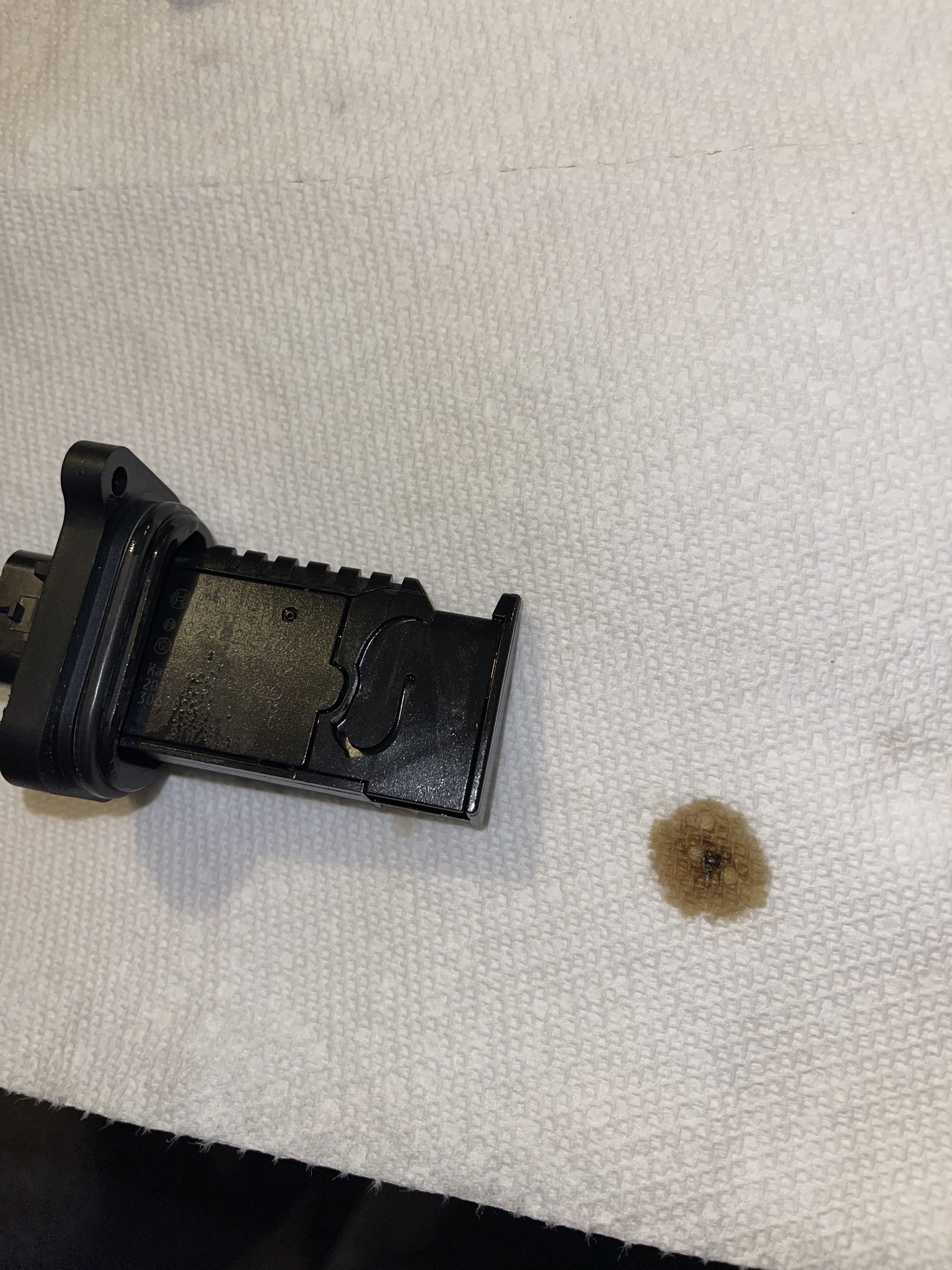

m5Anthony
15
Drives: bmw m5
Join Date: Jun 2024
Location: Connecticut
P120D code means Crankcase vent hose(s) could be damaged or disconnected, PCV valves could be full of oil, remove and check.
The other one points to the MAF sensors or its circuit that the inlet air flow to engine is not right, buy CRC MAF cleaner first and follow instructions to clean both of them.
Currently cleaning my maf sensors and i noticed one of them was very oily and some oil dripped on the napkin lets see if this fixes the problem will report back

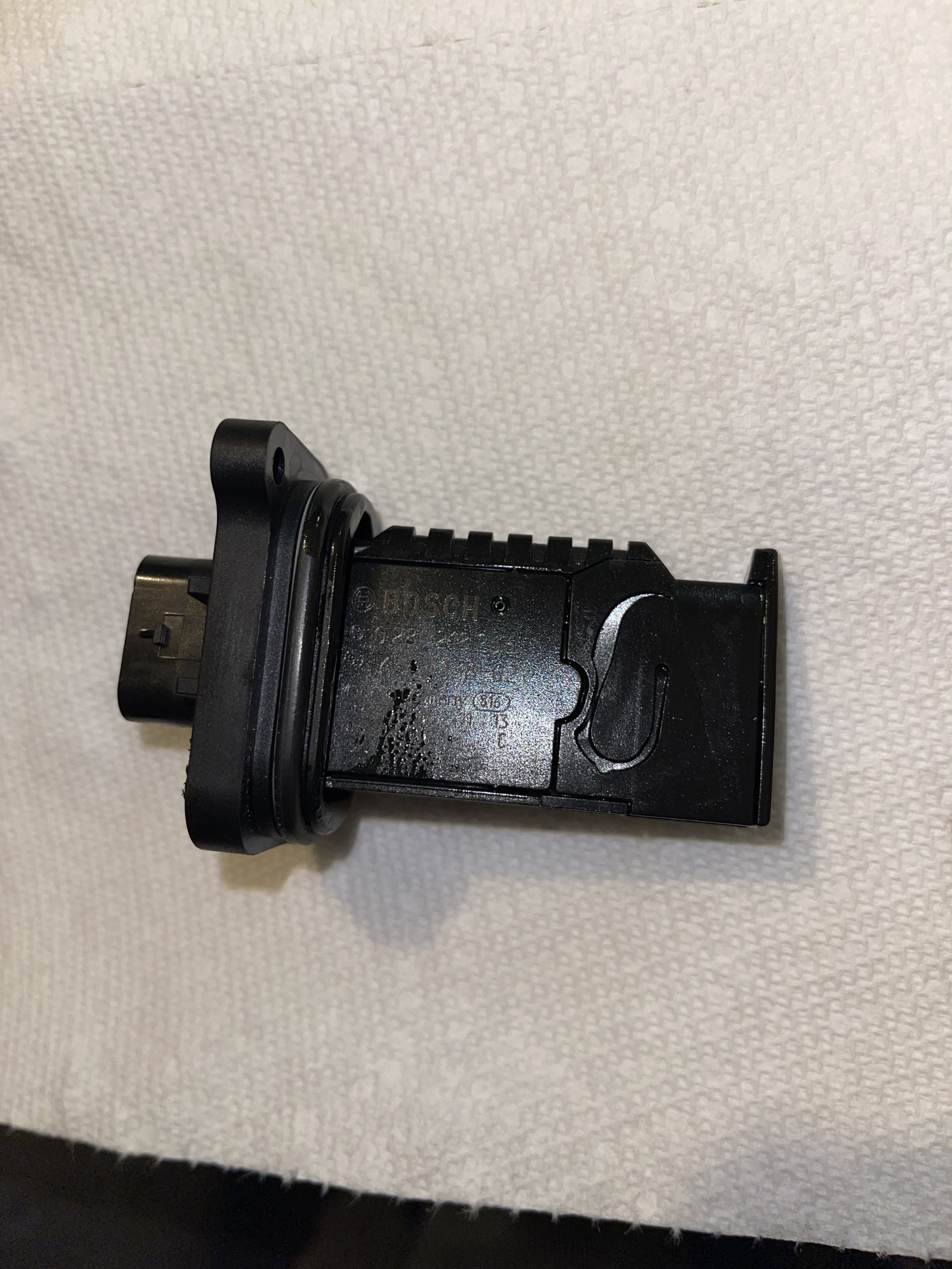

m5Anthony
15
Drives: bmw m5
Join Date: Jun 2024
Here are the maf sensors that i just took out, the passenger side one had some oil build up in it

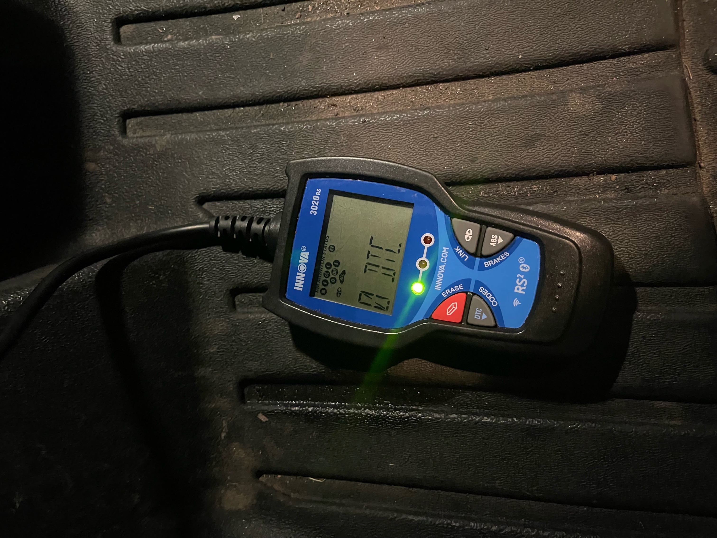

m5Anthony
15
Drives: bmw m5
Join Date: Jun 2024
Reporting back after putting back the maf cleaned and code looks like it went away. I took it for a long drive and kept on turning off the car and turning it on and the code did not come back lets see what happens

m5Anthony
15
Drives: bmw m5
Join Date: Jun 2024
Originally Posted by KurtsM5 View Post
You need new PCV hoses.
Reporting back and the code is completely gone and check engine light went away , It was the mas sensors that were dirty

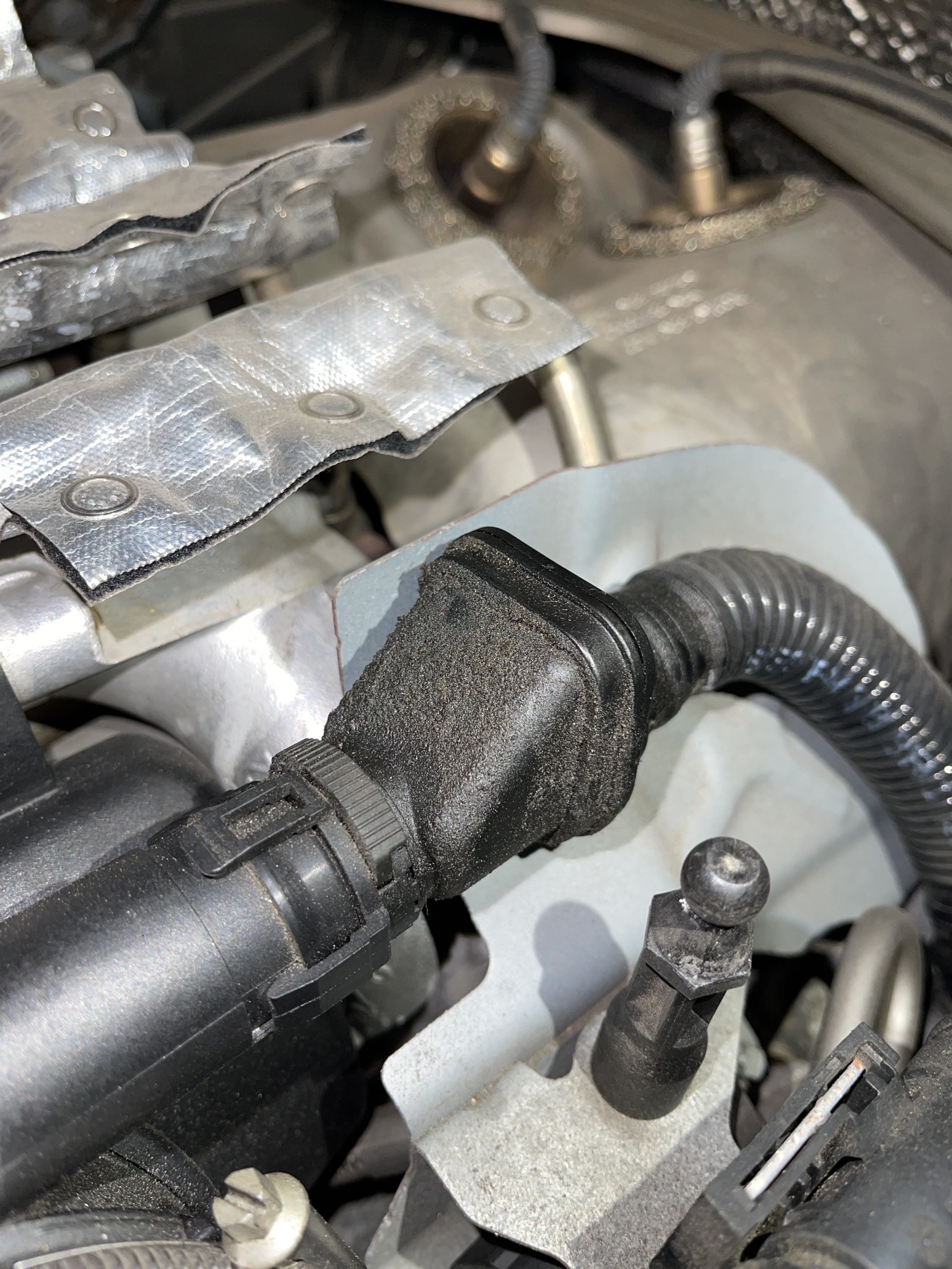

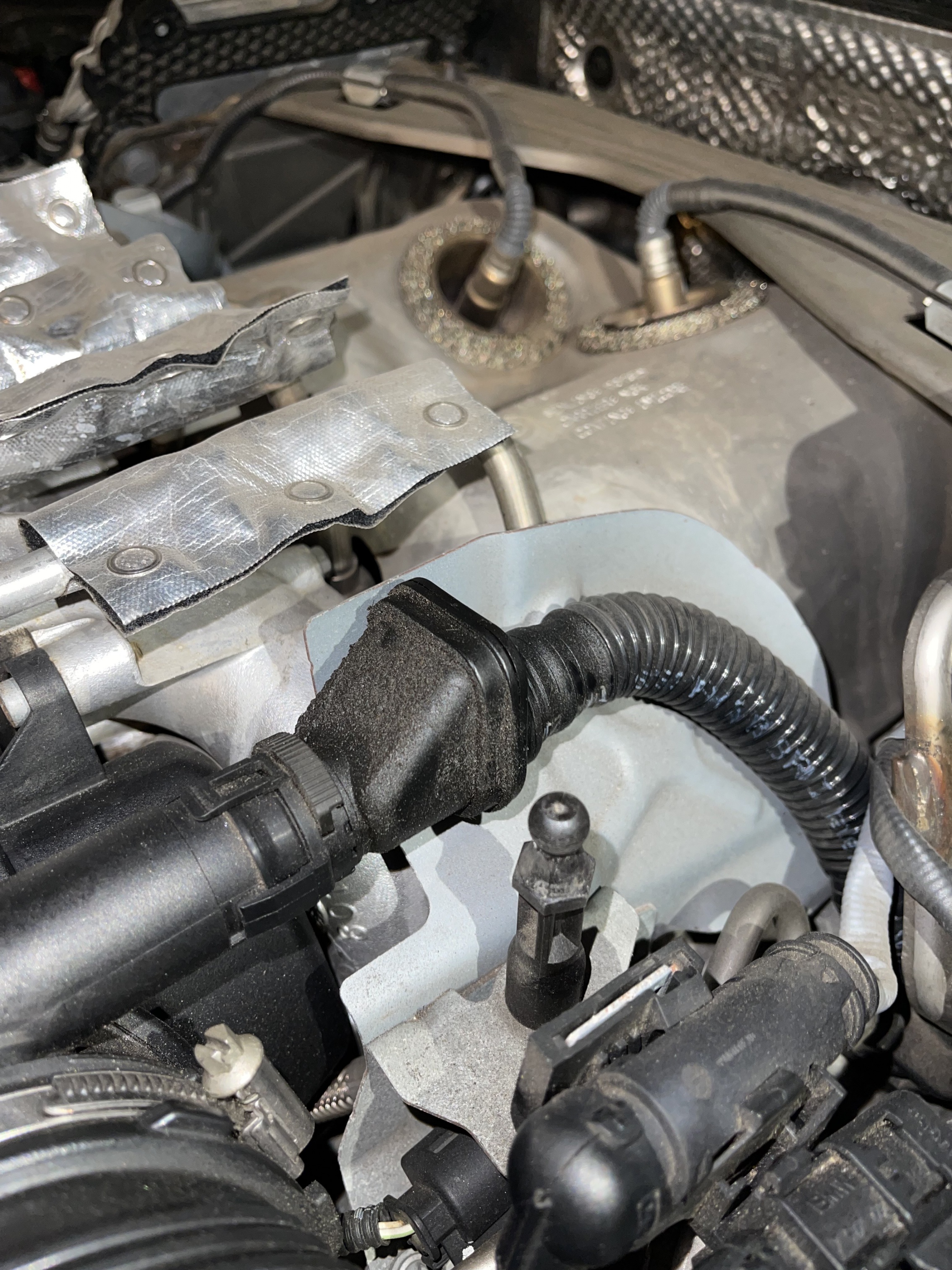

As you had a P120D code also its worth removing and checking the pcv valves if they are actually oil contaminated, especially the one from the oiled up MAF side. The pcv valves can have a little oil in them but if excessive will need to be changed as KurtsM5 suggests.
The clips holding the pcv valves on are very thin and easily breakable.
Is this considered excessive oil on the pcv valves ?
M5Rick90415.00
I would say a definite yes, it would appear the oil under pressure is bursting through the pcv seals so a blockage probably means a new PCV valve with the hose there.
I appreciate your input will definitely change these out just for preventative maintenance
