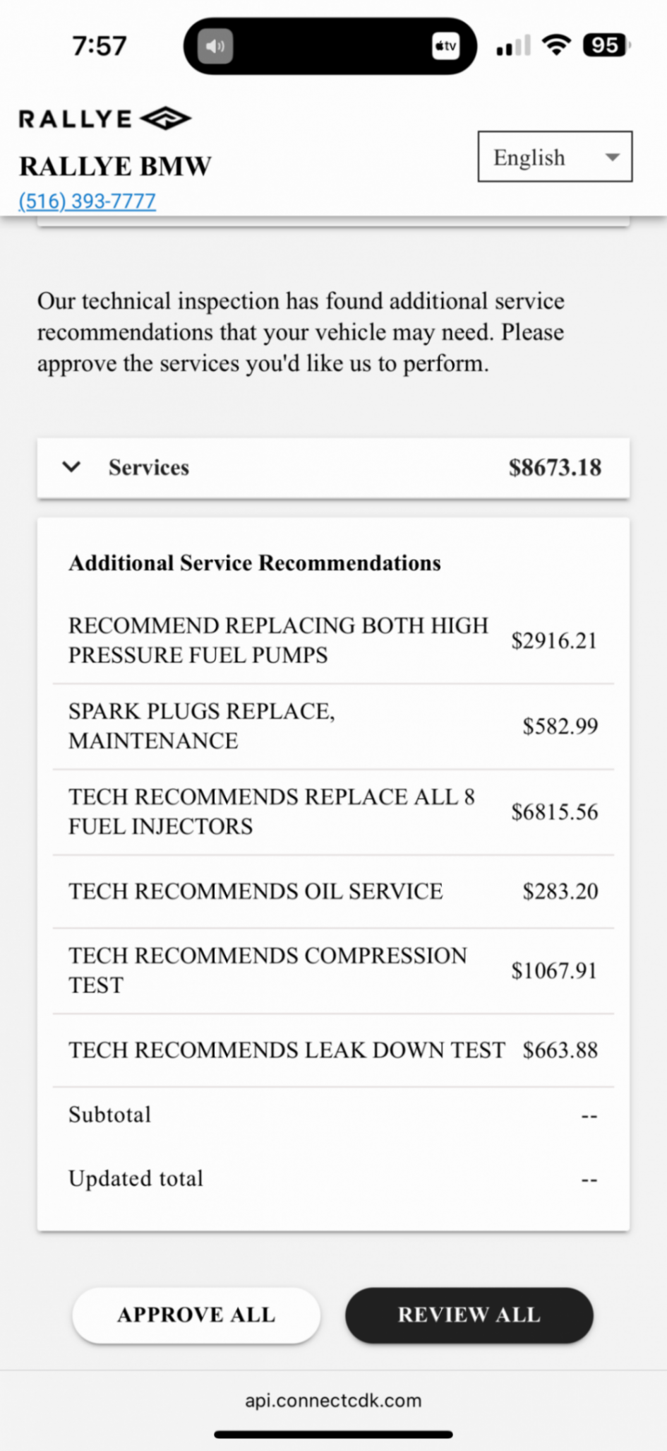

The car had to be shipped up from Virginia, and I finally received it on Monday. Took it out for a spin Tuesday and… boom — major issues. No limp mode, just full-on stalling.
Had to get it towed to my local BMW dealer, and wow… those repair costs add up fast.
Good news is the selling dealer is stepping up. They offered a full refund if they can’t fix it. They’re shipping the car back to their service department in VA to dig into the issue and see how bad it really is. Fingers crossed it’s not catastrophic.

Stalls. Heavy gas smell smoke out of tailpipes.
      05-09-2025, 05:39 PM   #5
90415
27,094
Uh oh that sounds like stuck open injector(s).

They are concerned about internal damage. Concerns are the excess fuel washed out the oil in the cylinders.
