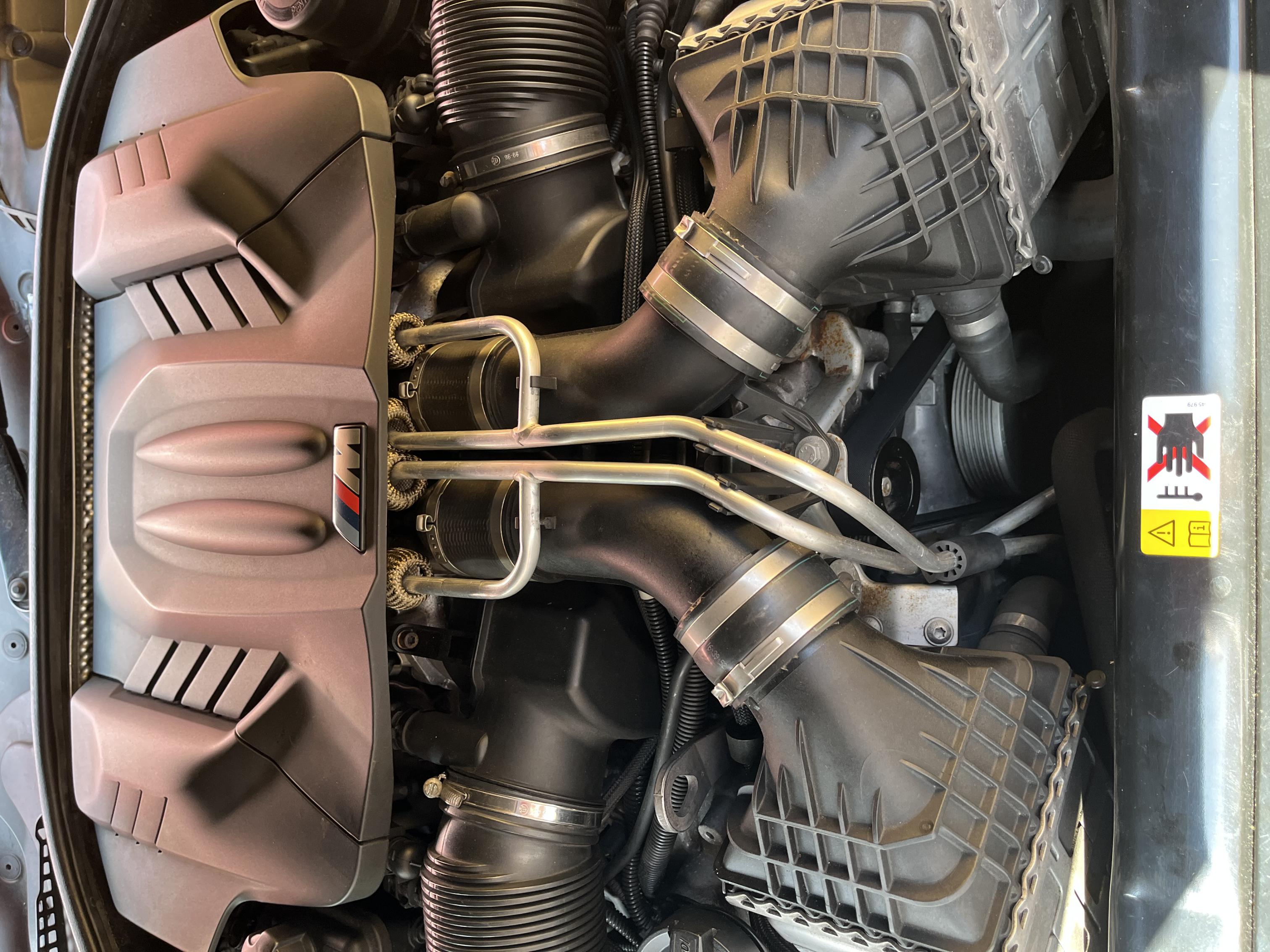

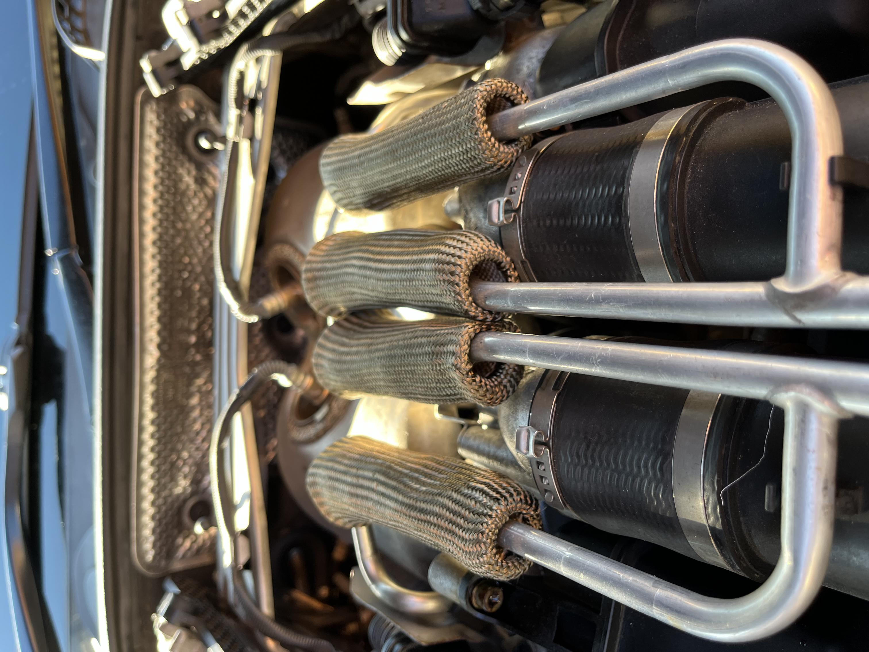

While I'm waiting for those corner parts I'm finishing replacing the troublesome turbo cooling lines with better more flexible slightly thicker impreganated micro hose pipes using the correct 21mm ear hose clips that are tightened with the special pliers provided in the kit, which don't over tighten the hose and finishing off with gold coloured tubular 5 inch long cloth type heat proof spark plug leads protectors, and... below those are silver heat proof rolled cut to size blankets that cover the hoses, so now you have twin layer protection. The old two middle hoses were almost rock hard and came off in pieces being careful not to score the ally pipes with the upturned Stanley box knife I was using.
The German name for these hose clips is Oetkiter and the originals were 18.5 mm but you'll never get them on or with great difficulty so the 21mm ones slip on easy onto the hoses (using a tiny amount of vaseline to ease the hoses over the pipes...no jokes please!) and tighten up just right without mashing the hose ends. If you ignore this service leaking coolant gets onto the rear of the turbos and can damage other components if excessive.

Here are the turbo coolant pipe covers.

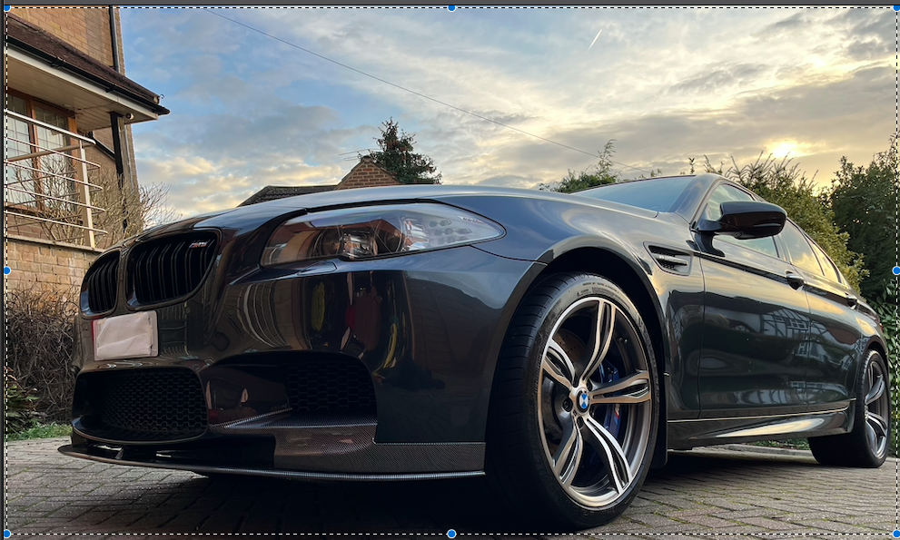

and... splitter fitted. Wasn't that easy but being a sunny warmish day took the plunge using my two small hyd' jacks lifting the front of the car a foot. if you have standard suspension then there's lots of room underneath.

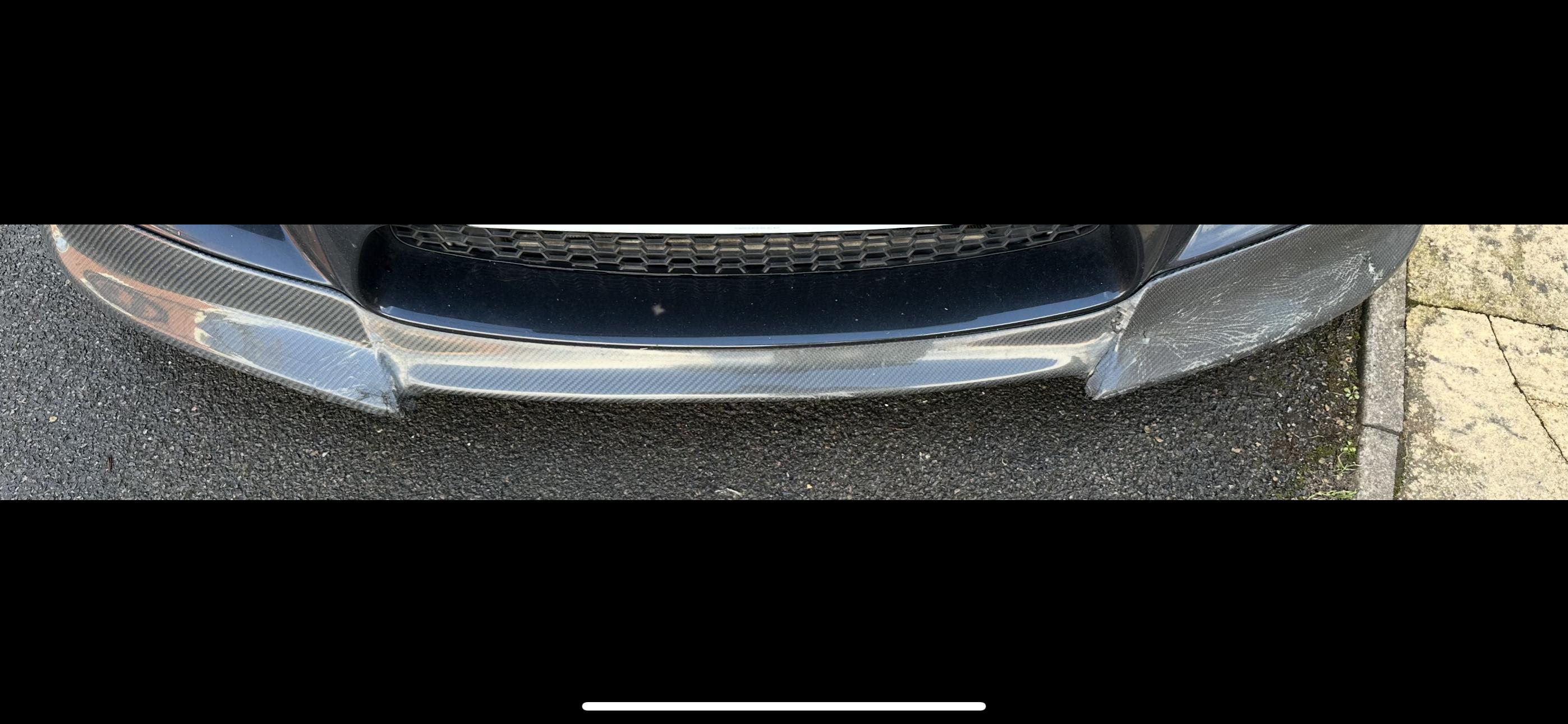

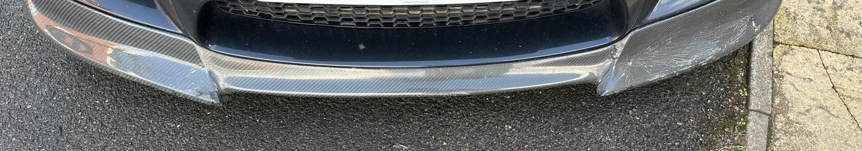

Mine literally snapped in places, thanks to raised iron works.
M5Rick90661.50

I suggest a wet/dry smooth down with filler then a heated wrap , naturally it would have to be removed for this.
I want to attempt, but really I would get someone else to do it…problem is getting it off, will have to either take the bumper off or drop the car with them.
Cannot find a like for like replacement, it was on the car when I bought it.
With what it would cost for someone else to do it, it may be more practical to get another new one of different make. Mine is ABS knowing if something like this should happen it can be inexpensively replaced using the special screws supplied being removed easily and another wing one slotted in, just it needs two of you with some duck tape to temporarily locate it after the corner pieces are installed to position the main wing to insert those screws into the locating corner piece holes.
I have two small hydraulic jacks which made the job much easier lifting the car from the front jacking points using the round slotted rubber jack cushions and removing the serrated jacking ends from the jacks so its a flat contact.
There are instructions on the internet of how others fit them also.

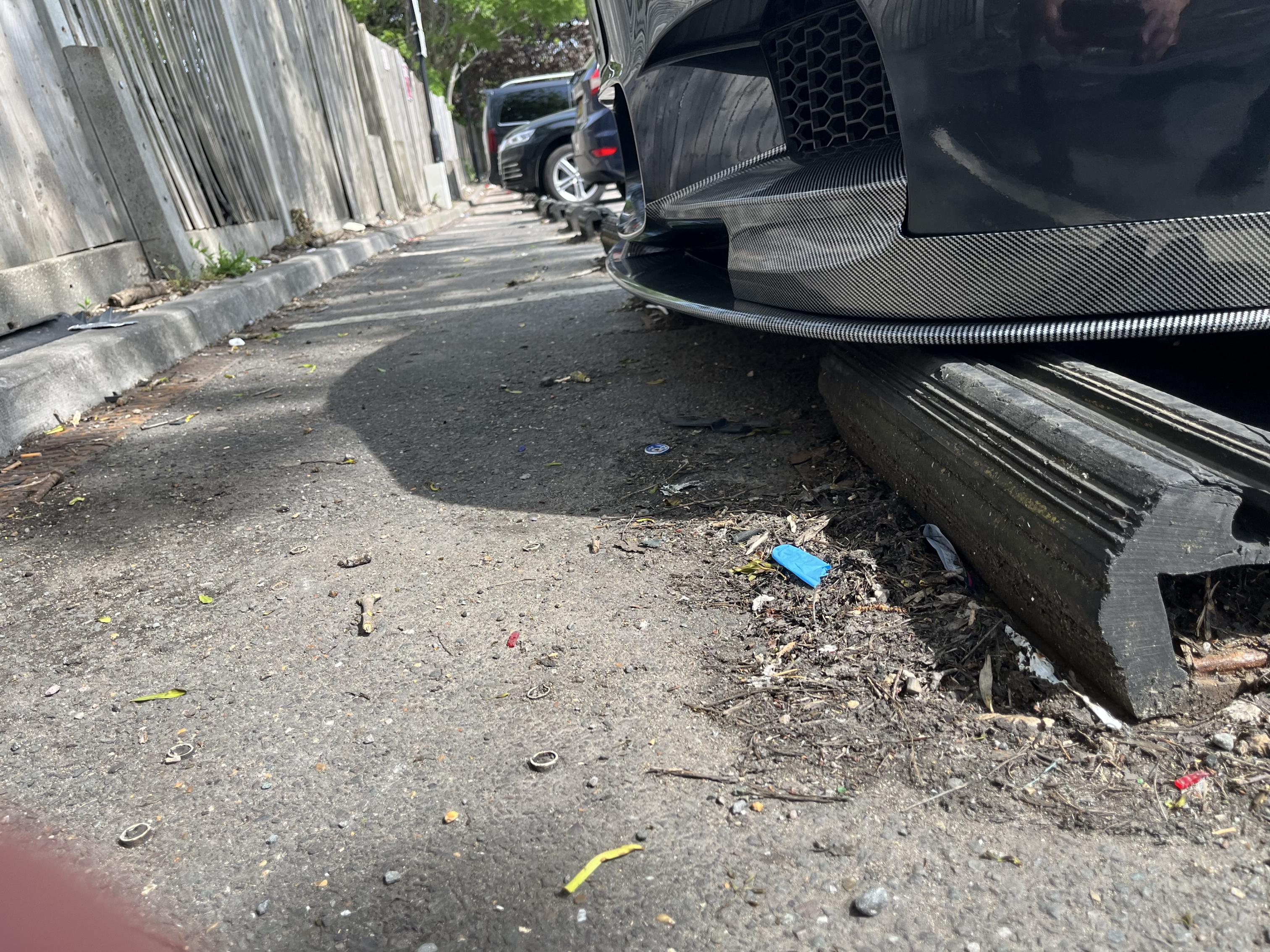

On a Comp or lowered M5 it would be sayonara splitter .

Wow🫣 that’s a close one! Is your car lowered already?

Standard M5 suspension from new.

Those new turbo cooling pipes don't look too bad with the PU cover back on.
