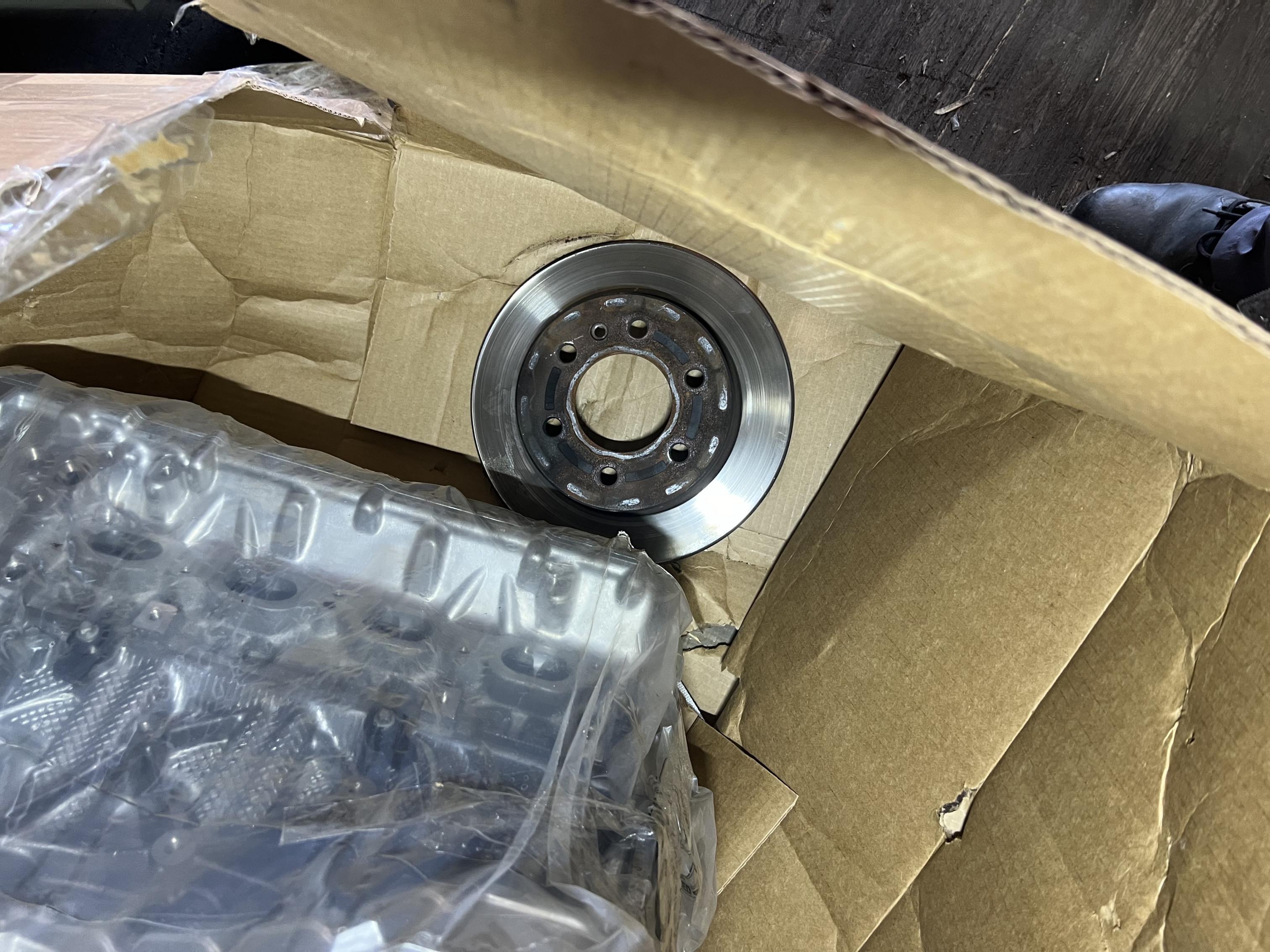

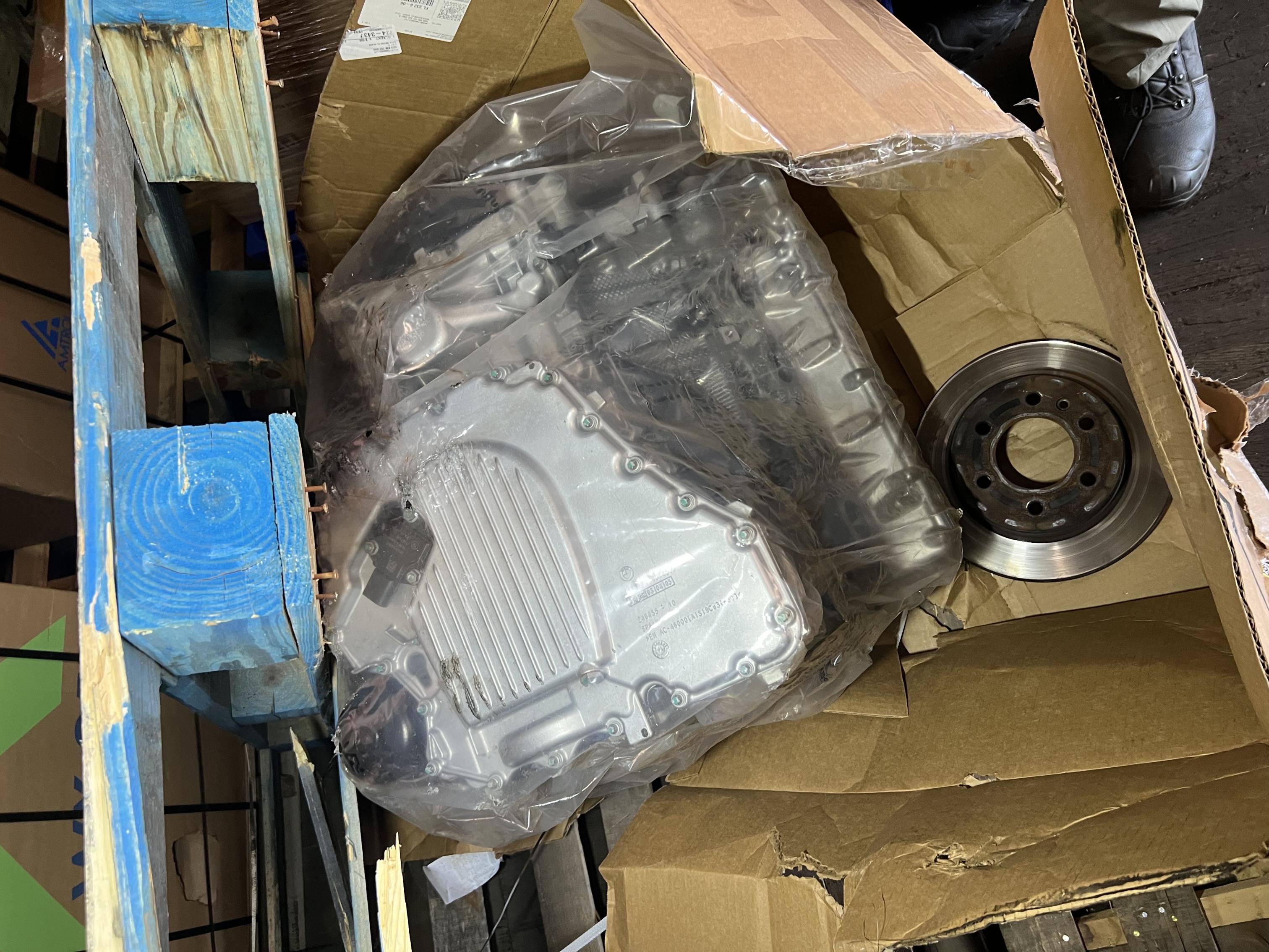

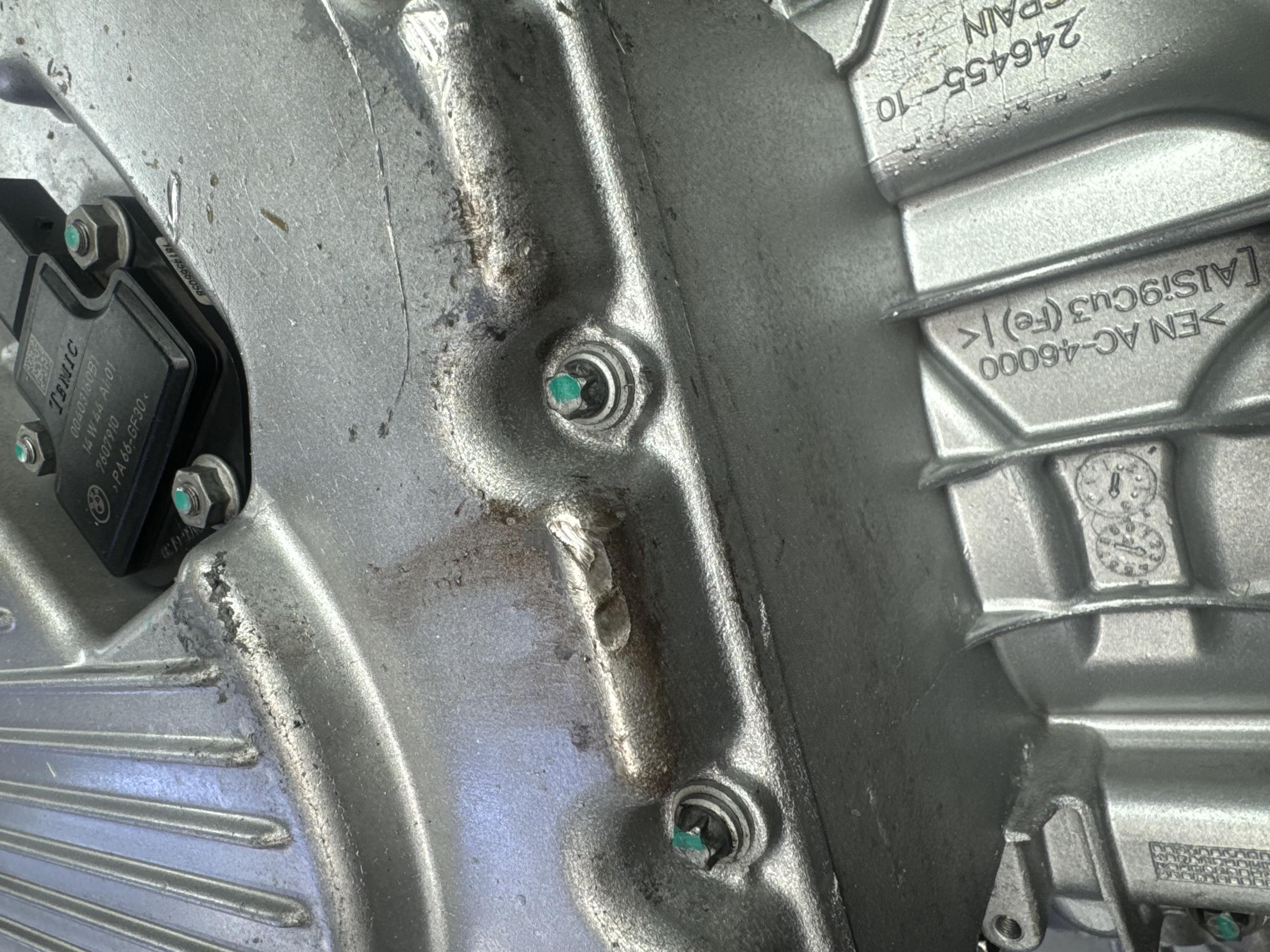

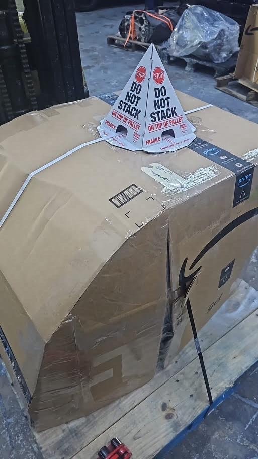

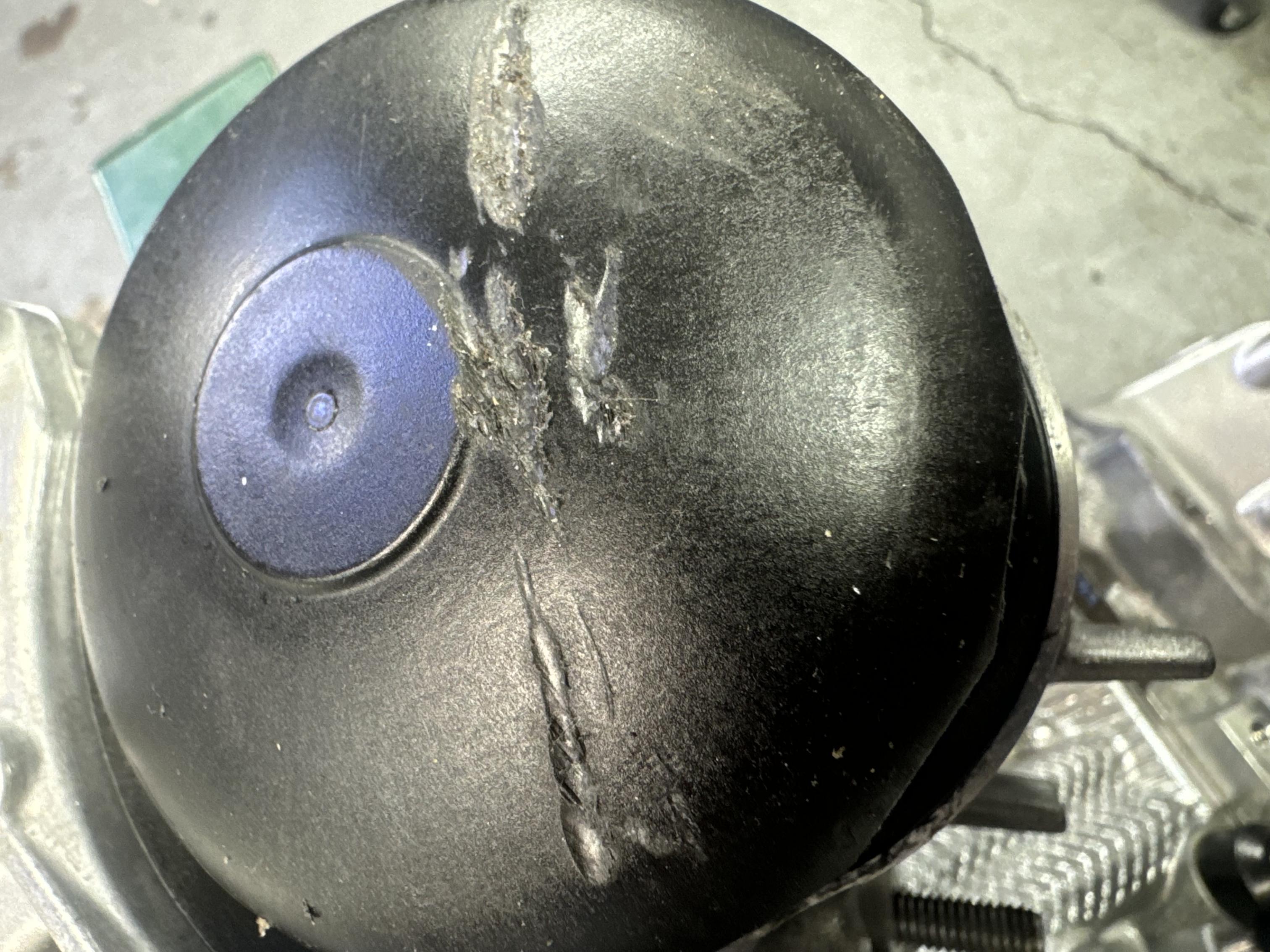

However, the issues began almost immediately. The engine arrived poorly packaged, with just a cardboard box on top of a pallet. Not surprisingly, the engine was flipped in transit, and I was informed by the shop installing the engine that it was damaged. I immediately contacted Pawel at Miami Engines, who reassured me the damage would be addressed and the engine shipped back promptly for repairs.
Here’s where things took a turn: Miami Engines had insurance coverage for the shipping damage, yet instead of conducting a full inspection or rebuild when the engine was flipped, they only did minimal repairs. The valve cover and oil pan, which were scuffed during the shipping process, should have been replaced, but Pawel assured me that cleaning and repainting would suffice, despite my suggestion to replace them. I trusted him, thinking that as the builder, he would ensure everything was up to par. However, in hindsight, a full rebuild should’ve been done, especially considering the engine had been flipped and the potential for internal damage. They didn’t do a proper inspection, which is crucial to this whole issue.

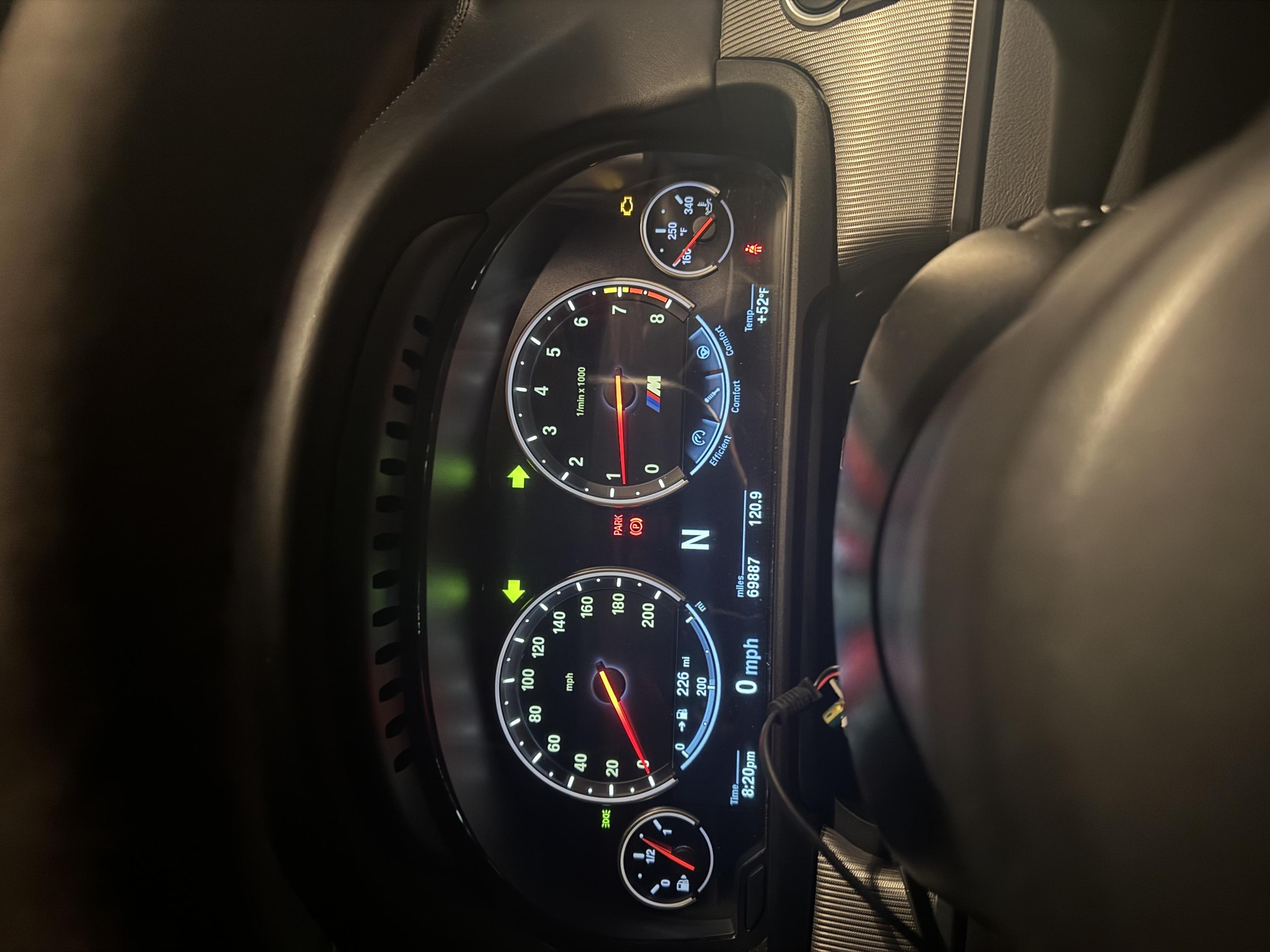

After receiving the engine back, the car exhibited fluctuating RPMs and rough idle after only 40 minutes of idle time & no driving. Despite my trust in Pawel, the issues persisted. I shipped the car to Miami Engines in October, 2024 for a thorough inspection, and they found additional problems, including misfiring cylinders and a jammed Vanos gear.
I was initially disappointed, as I felt these issues should have been identified during the original inspection and rebuild. Nonetheless, I agreed to have the Vanos gears replaced at a discounted rate, which cost me over $2,500. After this repair, the idle improved but was still not smooth.

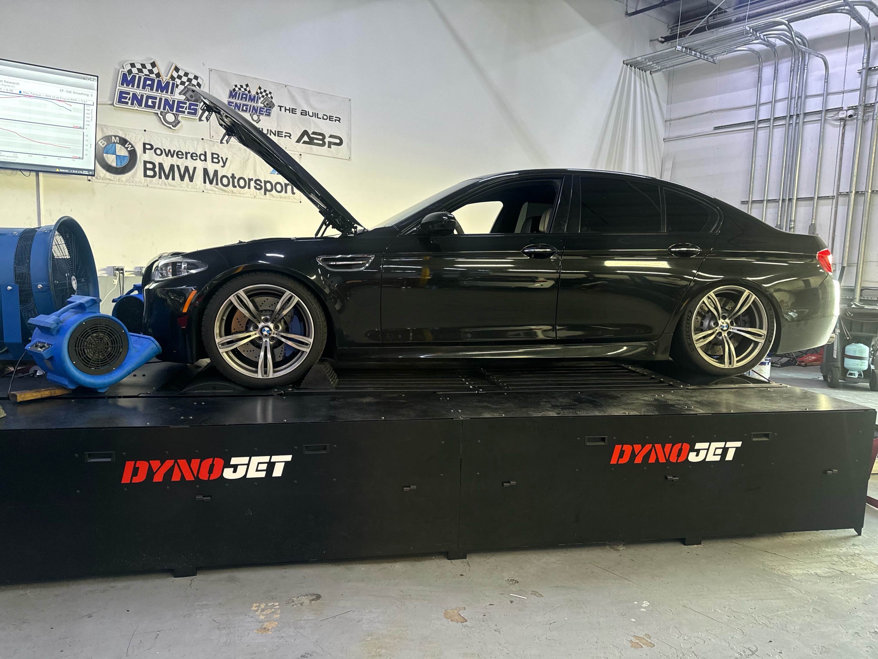

Despite numerous diagnostic efforts, including 400 break-in miles driven and tuning on the dyno, the car continued to misfire, with fluctuating idle and check engine lights. Ed, the service director, kept me updated, assuring me they were working on the issue, but after nearly a month, the problems were still unresolved.
Finally, in November 2024, I received the car back. As soon as I took delivery of the car from the transportation company, I noticed the check engine light was on, and the car was still misfiring. The misfires were present immediately upon delivery, and despite what I was told, the issue had not been resolved. I immediately contacted Pawel, who suggested that the change in weather from Florida to Virginia might be the cause. However, the misfires worsened, and despite multiple revisions to the tune, nothing seemed to help.
In January 2025, while driving the car on I-66, I saw white smoke coming from the exhaust, and the car went into limp mode with a drivetrain malfunction warning. I immediately contacted Pawel, and this is when he shifted the blame to my parts, specifically the head gasket, despite this not being the issue. After seeking diagnostics from two different shops, both confirmed that Miami Engines should be held accountable for the problems, especially since the engine had been damaged in transit, potentially affecting the block or other internal components. I have this in writing.

We shipped the engine to you, there was an accident with the engine being dropped by the shipping company, and you received it with minor damage, we apologized for this, had the Engine sent back for inspection. We had engine disassembled and inspected. The valve cover that got cracked got replaced, along with a couple other parts.

As you requested, we drove the car for several hundred miles to break in the engine, changed the oil and filter, and had the car tuned on our dyno.
it was making decent power, but we couldn’t push it further because your transmission wouldn’t hold on stock clutches, and the EU6 injectors you decided to use are not the best choice for high horsepower as their flu rate is much lower than EU5.

1. You did not replace the valve cover or oil pan. I have your text messages confirming this. You stated, “Valve covers and oil pan are fine, just scuffs to the paint; so we re-hot tanked both valve covers and lower pan early this morning and re-painted both.” I replied, “I was hoping to have the oil pan/valve covers replaced since the insurance company will be paying for them. If you think it’s OK and they won’t leak oil, then I’m fine with your suggestions.” I can share these messages if needed so you can jog your memory.
2. You did not fully disassemble the engine for inspection after the transit incident. I requested proof—photos or videos—but none were provided. I asked, “What would the damage assessing process look like? Would a rebuild of the motor be possible since the internals could have been damaged during the flip of the motor?” You responded, “Looks like they dropped the pallet and the engine got rolled over. Internally there shouldn’t be any damage… I’ll make sure it’s 100% before sending it back to you.” Later, you added, “I got the engine in the engine room, looked it all over, removed valve covers, engine is 100% intact.” This does not indicate a thorough internal inspection.
