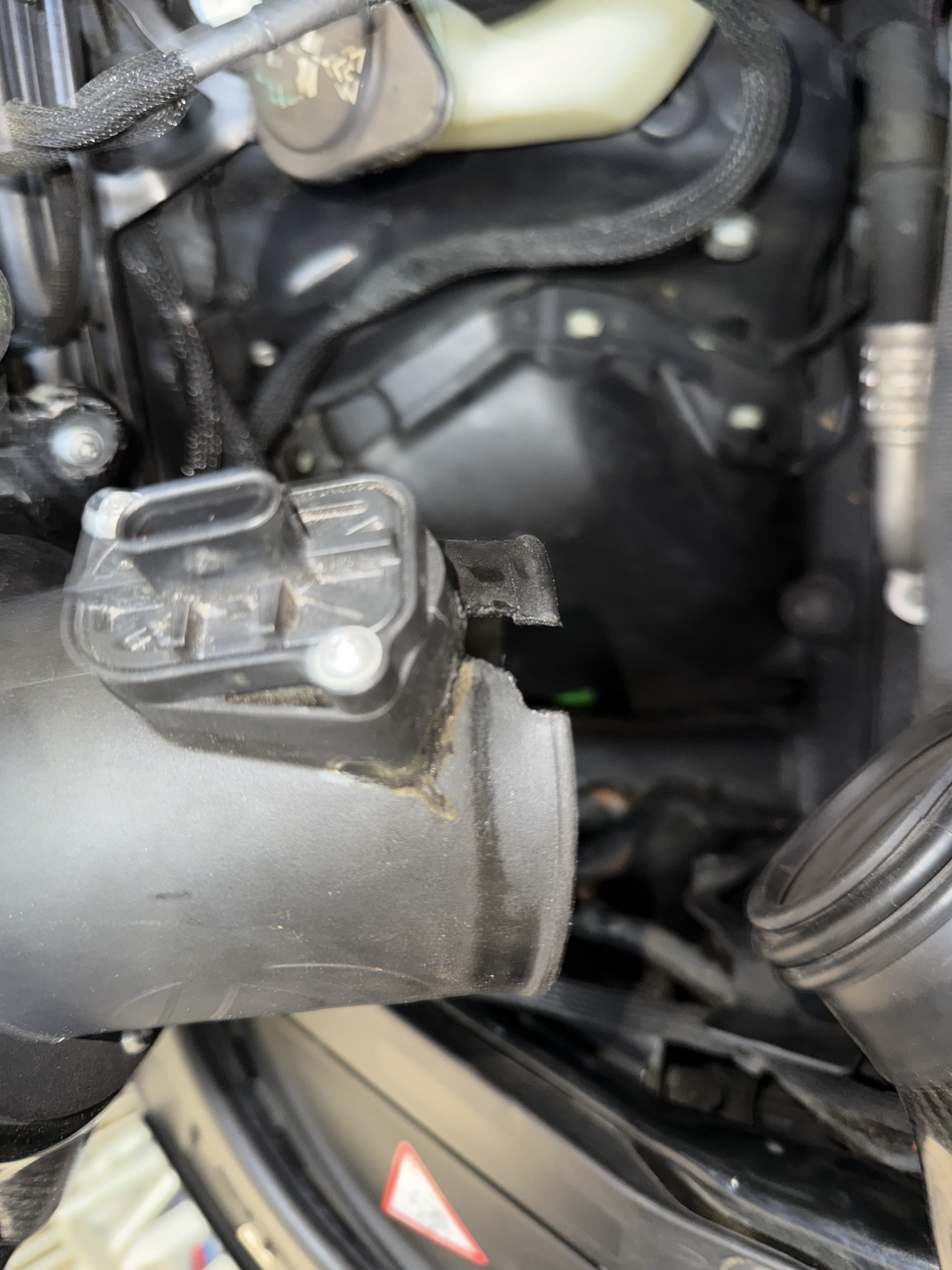

I found a crack in the intake hose between the maf and turbo in guessing that’s definitely the problem

Nice find! Agree, that’s more than likely your problem.

I replaced that cracked intake peice and there’s no more check engine light or code for any engine misfires but the rpms still wiggle slightly and I can feel inconsistent vibrations in the seat like it’s still misfiring. I have one code for the coolant outlet temp sensor but I don’t see how that would cause this problem. Only thing I can think of since th code isn’t coming back is to drive it around and have it reset ecu adaptations.
