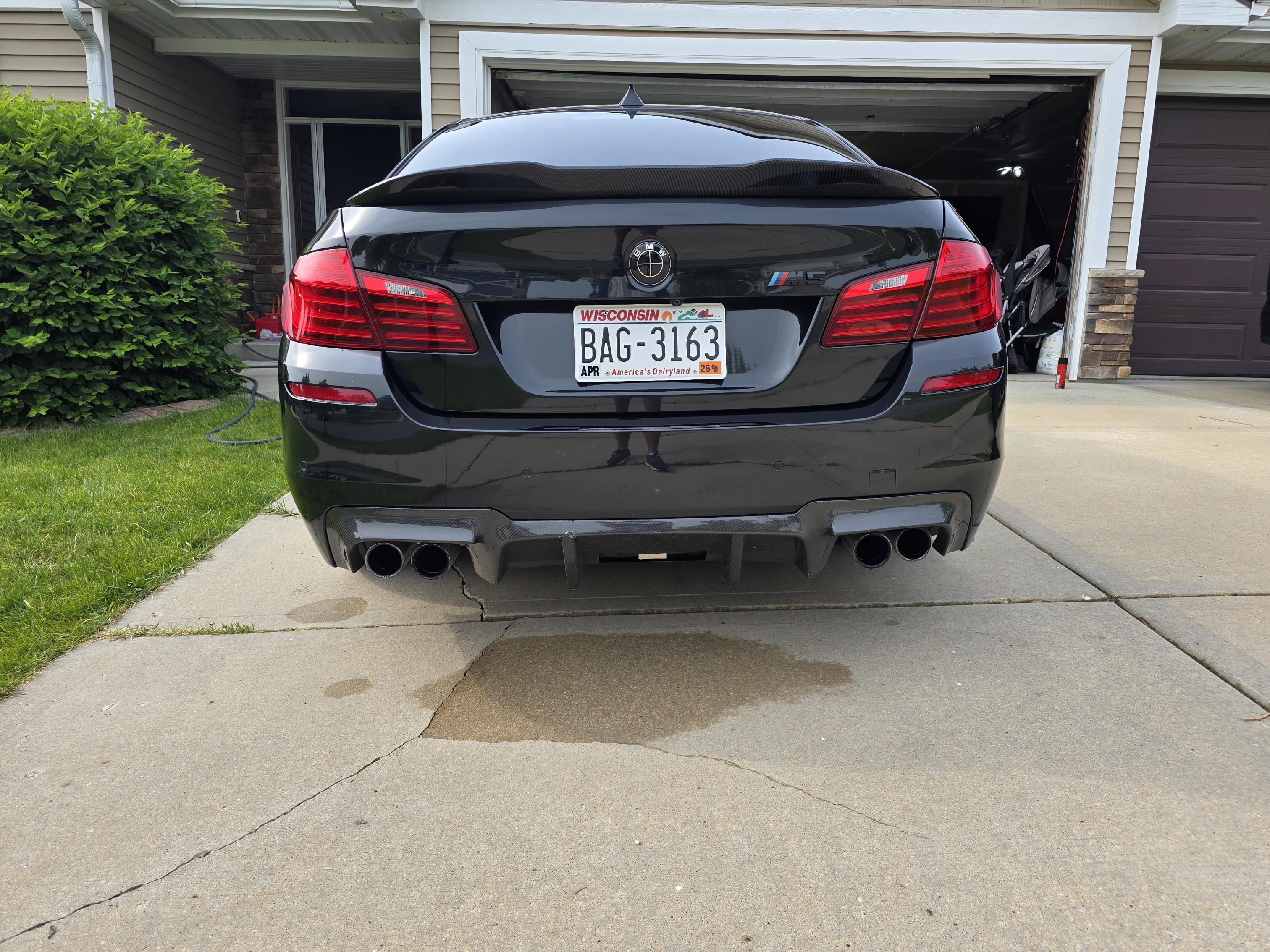

So here she is, the link to the sale is also posted and some updated pics. After I got it running 100% I did a baseline dyno on the car, it put out a very healthy 518whp (more than I expected) on 91 ethanol free octane. I added VRSF catless downpipes and an MHD tune with 93 ethanol octane and it put down 607whp. It feels amazing now, woken up, great torque curve and very solid to drive. This car will not be tracked, driven in winter or in the rain but it's an awesome car to add kiddo car seats to, go to cars and coffee events and enjoy on long drive up north to our cabin.
