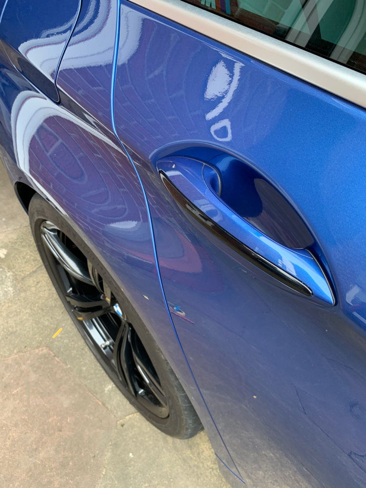

225
Drives: F10 M5 2015
Just ensure you tape up the handle/door before removing the strip.... they are only weak plastic and can mark pretty easily... easy DIY though
Nice work!
How were you able to get those out? i Tried to pry one out and the plastic ends broke off.
      09-12-2020, 02:05 AM   #19
J11SEK
J11SEK's Avatar
273
225
Drives: F10 M5 2015
Nice work!
Run a Stanley knife blade behind the silver insert strip to cut the double sided tape as you pry the insert out. Makes it far easier and less stress put on the insert
Where did you but the black strips from!!?
      09-30-2021, 08:11 AM   #21
J11SEK
J11SEK's Avatar
273
225
Drives: F10 M5 2015
It's a black gloss wrap, the post explains how to change it from chrome
