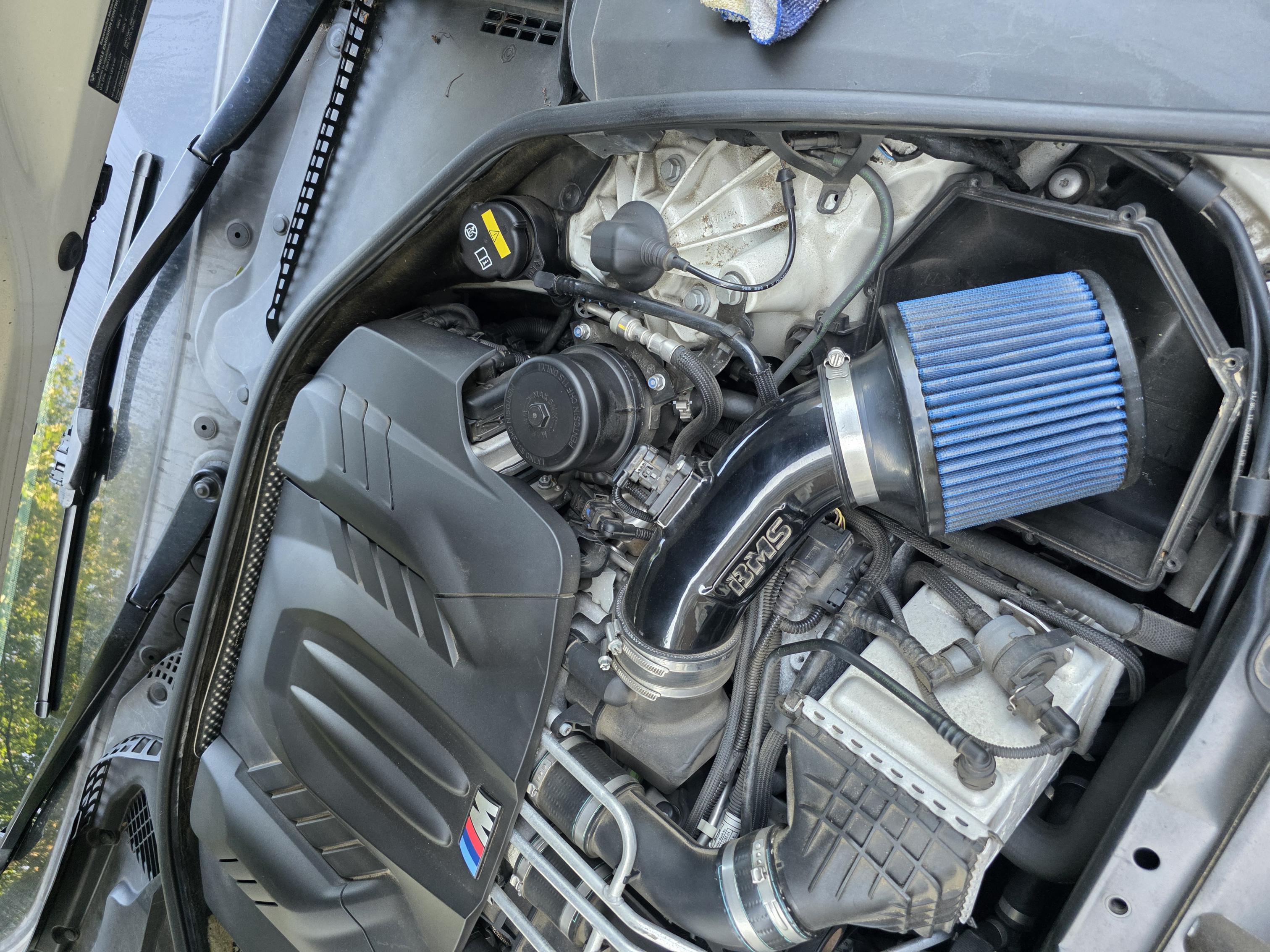

Hey bud. I know this thread is old. But my m5 started stalling(surging idle) only during cold start (does it when its 30f outside or 100f). I can restart the car immediately after the stalled and it usually runs fine.
I didnt think much of it until your last update. My car just told me to fill coolant. I check thr main one (passenger side, on the engine) and its full. I check the alt one and it looks dry. Wondering if I have this same coolant line leak. Where did you find the leak? Attached pic of side thay was empty and assume the coolant side you are referring too. It seems to be completely covered. I also dont see any fluid on thr ground either. Do you recall the part number or another thread that discusses your fix?
Any help is appreciated. Ty!

No. You are showing the main engine block cooling reservoir in the top right hand corner of the engine bay. It's normal to top it up once in a while with a 50/50 mix of only BMW a/freeze mix and distilled water to the bottom of the filler pipe.
The oblong coolant reservoir for the turbo intercoolers and DME's is to the left of the engine bay.
